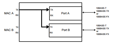

My customer wants to build a Ethernet ring network using DP83849IF and they took http://www.ti.com/lit/an/snla086b/snla086b.pdf  as a reference.
They've encountered with an issue that during broadcasting, only port A can transmit signal. They are using 100Base-TX full duplex mode with single clock.
Attached their schematic. eth_test.pdf
Could you please take a look? Please let me know if any information needed.

  • Hi Victor,
    Could you draw me a diagram of what the customer would like to happen when they use broadcast mode? As the DP83849IF defines broadcast, the device would transmit the signal from MII port A to both network segments(RJ45 A & B).
    As configured here, the customer has a MAC connected to each port, and broadcast mode would stop one of these MII ports from working.
  • Hi Rob,
    I think SCMII or RMII mode is required for broadcast mode, correct?
    They want both Port A and Port B can transmit same date from MAC A. While now they could only see data from Port A. from application note www.ti.com/.../snla086b.pdf
