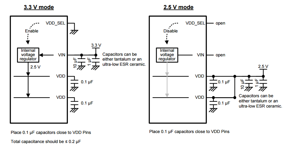

    3.DS64BR111 have internal regulator,when  VDD_SEL=”high”then DS64BR111 have internal regulator, VIN connect to 3.3V, VDD doen't need connect to outside power , may we check if just let VDD pins(pin 21 , 22) folating?
    4. if above point 3 is right, then i confuse the EVB "J22 – VDD_SEL = LOW: Use DS64BR111 internal regulator to convert 3.3 V supply to proper internal supply level of 2.5 V. Note: The 2.5 V level may be observed on the device VDD pins".

    3. VDD_SEL = LOW enables the internal regulator.  Follow the attached diagram for operation.
    4. The DS64BR111EVK User Guide is correct, connect J22 to achieve a "LOW" on VDD_SEL.  This enables the internal regulator.  Supply VIN = 3.3V.

    VIH should be tied to VIN if you are operating in 3.3-V mode and VDD if you are operating in 2.5-V mode. Since you are using the internal regulator, tie VIH to VIN.

    The VIH that you are referring to in the datasheet is an LVCMOS logic level parameter, for which the threshold for a "high" level is 2.0 V.
    The VIH that is used in the DS64BR111EVK is only used in the EVK, and this pin is specifically used in order to tie the logic for all other control inputs (for example, VOD_SEL and MODE) to the correct supply voltage. If you operate in 3.3-V mode, the inputs should be referenced to a 3.3-V supply. If you operate in 2.5-V mode, the inputs should be referenced to a 2.5-V supply. Using the VIH jumper pin on the DS64BR111EVK connects the correct reference for all of these control pins so that you can change the supply reference depending on whether you choose to operate the EVK in 2.5-V mode (VDD_SEL = Float) or 3.3-V mode (VDD_SEL = Low).
    For a customer design, it should already be pre-determined whether you will be operating in 2.5-V mode or 3.3-V mode, and so there will be no need for this VIH pin in the final layout.
