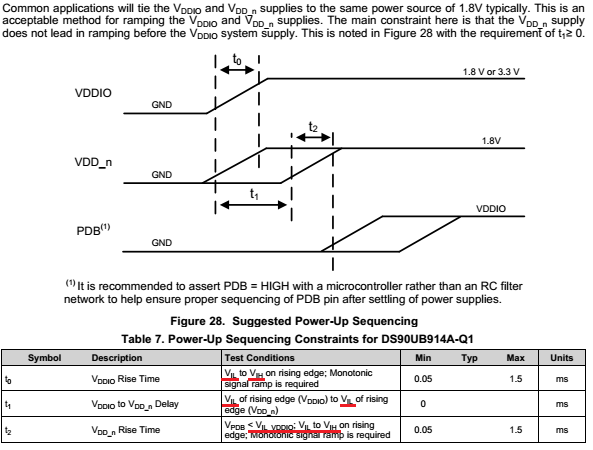

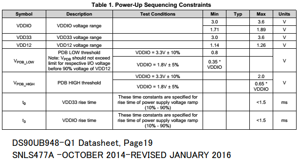

Hi expert,
Can you help me to understand power-up sequence correctly?

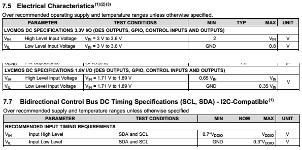

The datasheet specified as below, however, I cannot find out the clear definition of VIL, he VIH and VIL_VDDIO for VDDIO and VDD_n.
 I know that there are specifications of VIL and VIH for LVCMOS I/Os  and I2C interface respectively.
Shoud I use either one for VDDIO and VDD_n? or do you have any other definition for VDDIO and VDD_n?
Thank you for your support in advance.
Ken
