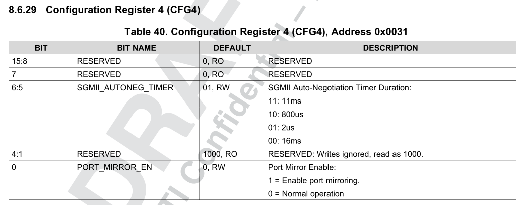

Let me confirm about below.
I found following thread on E2E. According to this thread, it seems if user use mode 1 or 2 for strap setting of RX_CTRL, auto negotiation issue will happen.
>Yes you are right. The issue has been solved by strapping RX_CTRL to Mode-3.
https://e2e.ti.com/support/interface/ethernet/f/903/t/490569#pi239031350=2
Is my understanding correct ?
If so, even if user will set SGMII auto negtiation enable setting by using register(Add 0x0014[7]=1), does this negtiation issue will happen ?
