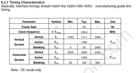

1.      The below is the panel timing  has ever enabled our target panel to work in other bridge IC( LVD-to-eDP bridge )
Resolution = 1920x1080
vertical_sync_active = 2
vertical_backporch = 4
vertical_frontporch = 2
horizontal_sync_active = 18
horizontal_backporch = 50
horizontal_frontporch = 50
2.      The panel does not support ASSR mechanism.
3.      The data format input to the panel is RGB 666.
