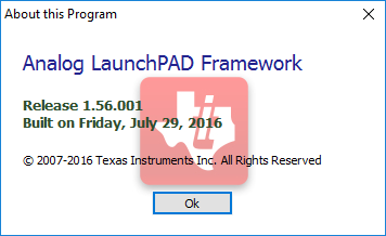

I am not able to get the drivers working for the SD1983EVK evaluation board of the LMH1983 on Windows 10 x64.  I'm running ALP version 1.56.
When I run ALP I get the error: "No attached ALP based USB boards were detected."

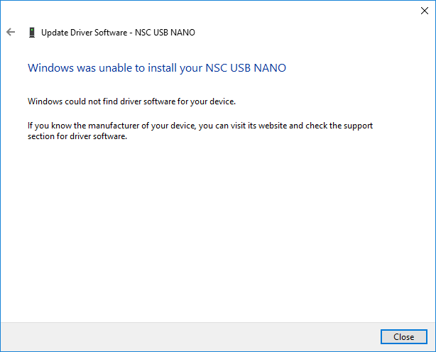

I've downloaded the drivers from Cyprus as I read from the help menu, but when I try to install the driver in device manager it doesn't recognize the drivers I download.
What should I do to get my computer to recognize these drivers?

  • Yes, your solution doesn't work for me. I used that thread to help me try and install the driver, but no matter which folder I try, it doesn't work. I also tried the base folder and selected search all sub folders. My OS is Windows 10 x64 and that folder doesn't recognize the driver.
    Has anyone tried installing on Windows 10?

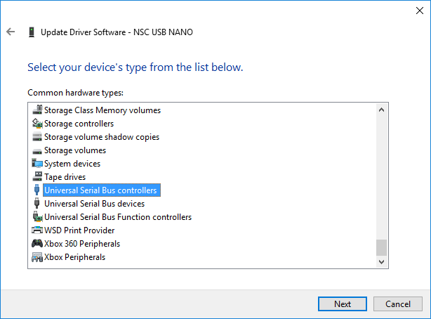

  • Yes, I know there is a win 10 driver and I am following your guide.  I poked around some more and I think I've solved the problem now.
    On Win 10 after step 8 I get a different window and was selecting USB device instead of USB controller. Once I selected USB controller I was able to move onto step 9 and complete the install with the Win 10 driver. For Win 10 may I suggest Step 8.5:
    Step 8.5: Select device type Universal Serial Bus controllers and click next.
