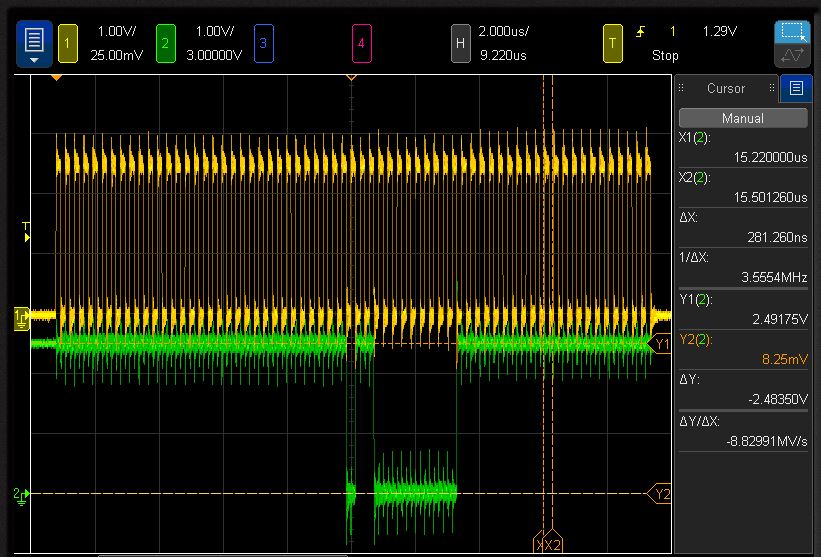

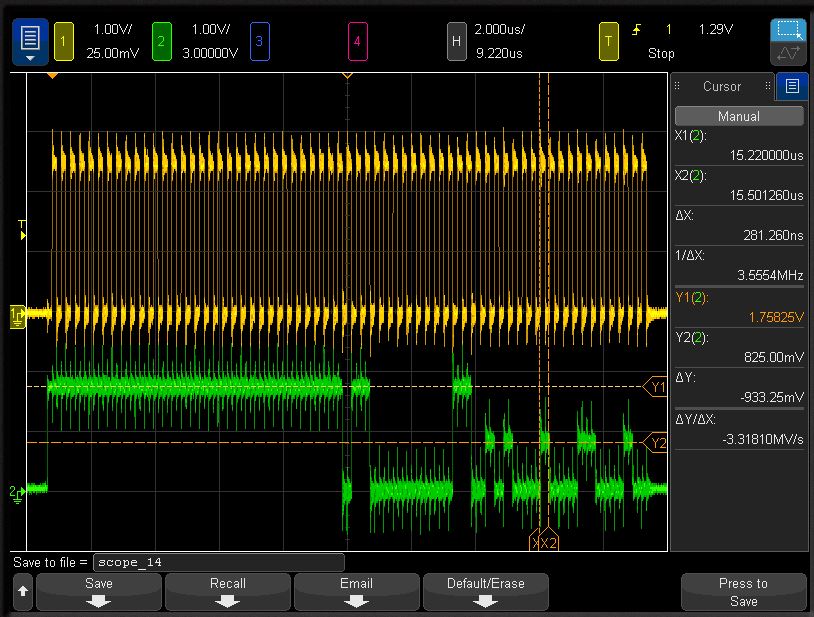

  • Rob,
    It really looks like the problem does not concern VREF. I've attached two scope shots. The first one shows MDC and MDIO for attempted read of register 0x03 when the PHY reset is asserted low. Notice that the levels of MDC and MDIO are 2.5V, as they should be. The second image shows an attempted read of reg 0x03 when phy reset is high. Here, MDC levels are still correct, but MDIO is not pulled up to 2.5V. If MIO_VREF (or anything on the fpga side) were the issue, I would expect for the problem to persist even when phy is in reset.
    There is another copy of this board, but I do not have it. I'm going to see if I can get someone to do the same tests on that board to make sure that it's not just the chip on this particular board.
    Read of register 0x03 when phy in reset
    Read of register 0x03 when phy not in reset

  • Will,
    I was able to reproduce your error, I believe, by strapping the GPIO_0 pin to mode 4, which is a restricted strap mode.
    Your schematic does not show a pull-up on GPIO_0 but your FPGA may have an internal pull-up.
    Please place a significantly strong pull-down on the GPIO_0 pin to pull the voltage down to the threshold stated in the datasheet.
  • The GPIO_0 strap was indeed the problem. I had internal pull-ups on both GPIO lines. After removing those, I can now talk to the phy. Still can't send/receive packets, but I assume that's related to the bad strap mode I have on RX_CTRL.
