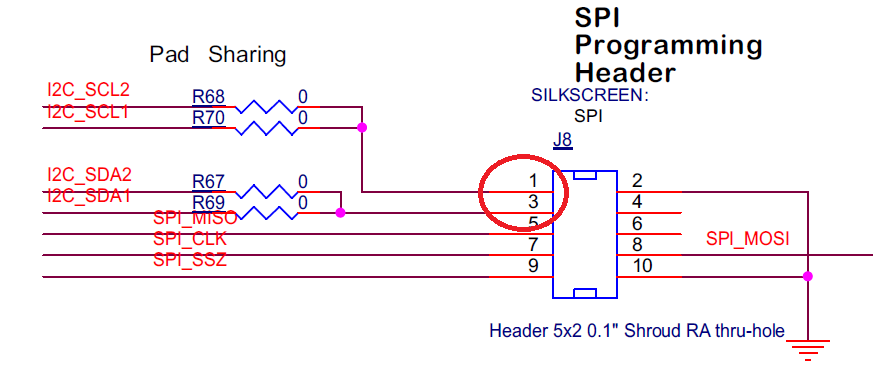

      When I  connect the Aardvark to the SPI programming interface header on the TUSB546EVM, I observe that the I2C lines (SDA and SCL) are being pulled low( should be pulled high) and no I2C traffic is captured when I write something from the Aardvark GUI.
    I have confirmed that this is not due to a faulty Aardvark as I have tested the Aardvark separately and it is pulling the lines high as expected.
    Is there any other component on the EVM board that I may have missed which may be pulling the I2C lines low?

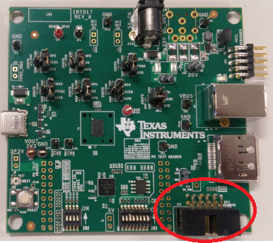

  • Hi Moises,
    This above circle is the SPI Programming Header that I had connected the Aardvark to, as it has the I2C lines as found in the EVM schematic below:
     From what I understand, using these I2C lines, we should be able to talk and access the registers of the TUSB546 directly housed on the EVM.
    In response to your query, I measured the voltage on the I2C lines (pins 1 and 3 in the figure above) without the Aardvark and on reset.
    It came to be around 10mV. It seems they are low.

  • Hi Abhijit,
    I have reviewed the EVM, it seems TUSB546-DCI was intended to be controlled by TPS65982 by GPIO, however, the I2C lines are connected to the TPS65982 which may be setting a low level.
    Besides, in the EVM, SDA signal is wrong wired.
    To only control TUSB546-DCI you will need to remove connection from TUSB546-DCI to TPS65982 and connect the aardvark to the right I2C pins from TUSB546-DCI. This will require removing of some components and extra wiring. Finally there won;t be communication between TUSB546-DCI and TPS65982.
    We can have a call to discuss it.
