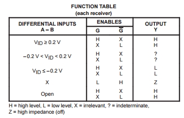

    On the other hand, I have additional question about VID.
    At the following table, VID is defined +/-0.2V. Also VID means differential inputs (A-B).
    I think VID is not A-B. It is VIT+ or VIT-. Is that correct?
    If VID is A(VIT+) - B(VIT-) , VID is 400mV. I am confused.
    If the above VID is just voltage level, the above 0.2V is maximum value. (typically +/-60mV as shown at Fig 8)
    Is my understanding correct?

  • Hello Hamamoto-san,
    VIT+ and VIT- values are the threshold parameters of VID. When VIT+ has a max threshold of 200 mV, any voltage greater than that will be read as a high (VID ≥ 200 mV). the values of VIT+/VIT- create the "thresholds" for VID.
