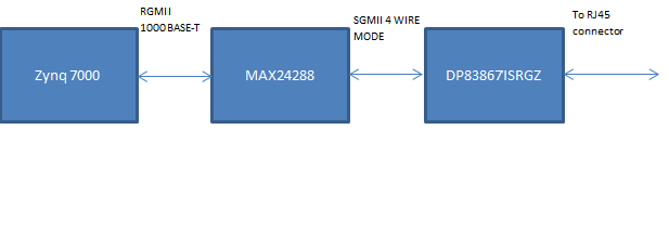

Hi everyone,
I'm working on  Zynq platform. I have tested RGMII mode on DP83867ISRGZ.
Now working with MAX24288 parallel to serial converter.
Auto-negotiation for DP83867 speed is completing with 1000Mbps.
but the SGMII Auto-negotiation with MAX24288 is not passing.
There is a level translator CML to LVDS between MAX and DP83867.
I have followed same sequence for configuration of DP83867 as RGMII. except
Register 0x10 SGMII enable
0xD3 for SGMII 4 wire mode
and Auto-negotiation speed advertise for 1000, 100 and 10Mbps
here Auto-negotiation is passing and then SGMII Auto-negotiation is enabled
here it is not completing SGMII Auto-negotiation.
I've shared the communication diagram.
Please suggest if anything missing and also the steps to be followed.

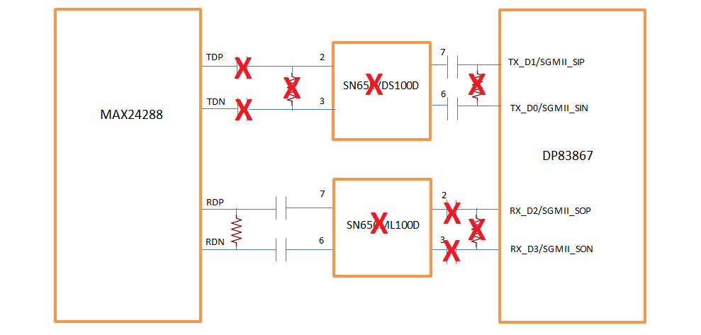

    Is it Ok to remove the conversion from CML to LVDS between MAX and DP?
    Even we are doubting the interface between MAX and DP since the MAX is detecting remote fault and it is also indicating CDR loss of signal and loss of lock. I have shared the interface diagram here.
    all the capacitors are 0.1uF and resistors are 100ohm.
    Please do have a look at it. and suggest what can be the reasons for the Receive CDR Loss-of-Signal.
    Sukanya.K
  • Hi Sukanya,
    You do not need the CML to LVDS converter.  We implement the SGMII link as LVCMOS and ensure the AC parameters match the LVDS spec.  Then we suggest AC coupling the LVDS to our LVCMOS.  It looks like the MAX is doing the same scheme.
    I'd recommend changing your circuit like the following.  Please note the DP83867 has an internal SGMII termination, so the 100ohm diff term is not necessary.
  • Hi Rob Rodrigues,
    Thanks for the suggestion.
    We have tried the circuit changes as specified, with different autonegotiation timer durations at register 0x0031.
    Also we have tried the force speed at PC side to 100Mbps half duplex as suggested in the link,e2e.ti.com/.../490569
    but no success.
