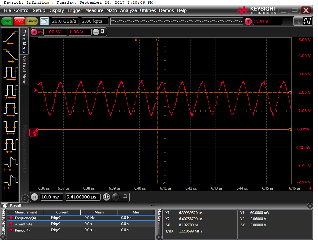

Hi, we use TI DP83867IRRGZR PHY on Rockchip RK3288 platform. The 18 pin  CLK_OUT of DP83867IR need to provide 125MHz clock to meet CPU RK3288’s spec.
But it’s always 25MHz CLK-OUT. We had configured register[12:8](CLK_O_SEL) to 0x08,0x04,0x00, but the CLK-OUT is the same 25MHz,
and I back to read the register value, it’s my configured value.
So what can I do next?  thanks!

  • 125M CLK is ok, but phy still can't work. (0x0170=0xe,Clock Output Select: Channel A receive clock)
     Is there any other suggestion? Thanks.
  • "125M CLK is ok, but phy still can't work. (0x0170=0xe,Clock Output Select: Channel A receive clock)"
    You mean, you are able to see 125 MHz clock on CLK_OUT.
    Can you please explain the problem you are facing now ?

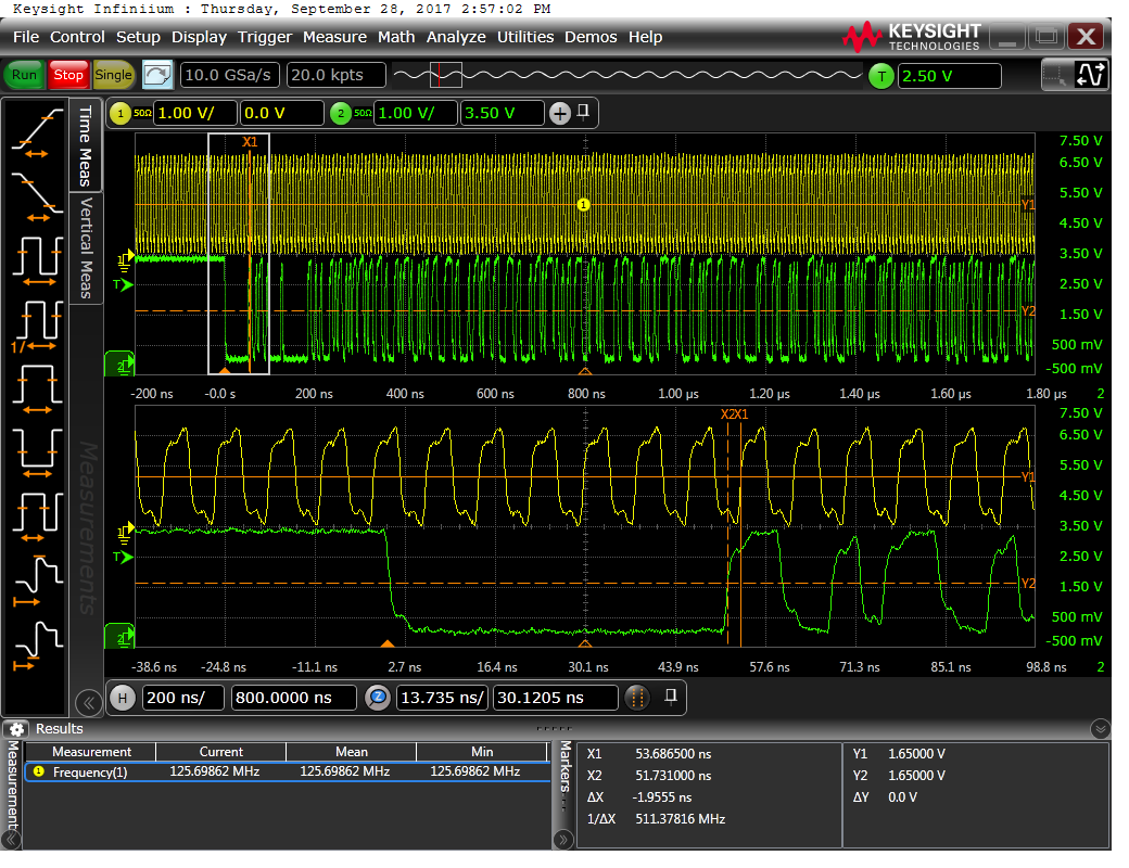

    and i enable the tx_clk/rx_clk delay ,my configurations as following:
    val = phy_read_mmd_indirect(phydev, DP83867_RGMIICTL,
    DP83867_DEVADDR, phydev->addr);
    val |= (DP83867_RGMII_TX_CLK_DELAY_EN |
    DP83867_RGMII_RX_CLK_DELAY_EN);
    phy_write_mmd_indirect(phydev, DP83867_RGMIICTL,
    DP83867_DEVADDR, phydev->addr, val);
    delay = (0x7 | (0x5<< DP83867_RGMII_TX_CLK_DELAY_SHIFT));
    phy_write_mmd_indirect(phydev, DP83867_RGMIIDCTL,
    DP83867_DEVADDR, phydev->addr, delay);
    val = phy_read_mmd_indirect(phydev, 0x0170,
    val &= ~(0x1f<<8);
    phy_write_mmd_indirect(phydev, 0x0170,
    our 1000M rgmii interface's waveform as bmp files
    Do you see issues on Rx or Tx path for ping ? Are you able to see your peer receiving the ping command ?
    To configured the delay on RGMII interface, delay introduced by routing on Tx and RX paths has to be computed and additional delays can be introduced using the register 0x0086 as done above. Please refer to below Application Note on how to compute the delay numbers and compute
    Alternatively, you can try few numbers to see if you get the data going thru the interface ?
