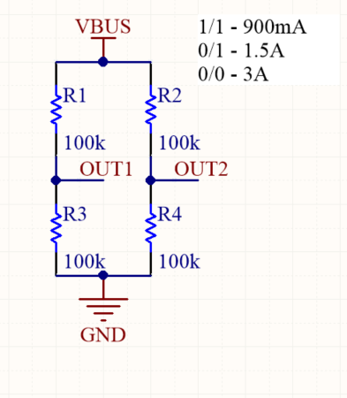

Hi all,
I am designing a USB device with a USB type C connector as output of the device.
In order to make the bridge from USB3.0 to USB type C we have choosen the HD3SS3220 IC.
As a USB3 device, the HD3SS3220 shall be configured on UFP mode (isn't it?). To make the design simpler, Iwould like to configure the HD3SS3220 in GPIO mode with the default type C current advertisemnt.
There are any other parameter that shall be configured? Will the device lost any capabilitie with the GPIO mode instead the I2C mode?
Thanks in advance.
