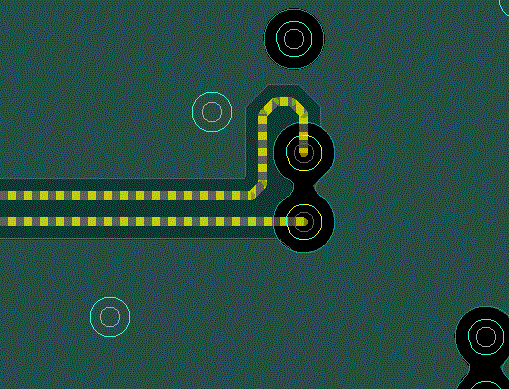

My customer is designing with DP83867IS. Their MAC connects to PHY through SGMII. Attached file is their schematic. The problem they met is the ethernet link is not very stable. When they PING their equipment through PC some times they cannot get any response. A strange phenomena is it seems the issue is related to the coupling capacitance on SGMII signal line. When they use 0.1uF cap, the condition is the worst, while when they use 100pF it seems the condition is a little better. I also had customer done loopback testing. The problem exist in near end loopback mode. So we think the rootcause is in the design of PHY ckt.
I am not familiar with Ethernet. Could anyone please help me with this problem?
