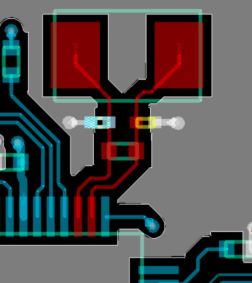

We are interfacing TI Processor DM8147 with Ethernet PHY DP83867IRPAP in our design.
We are able to ping for 10Mbps and 1 Gbps. However, 100Mbps does not seem to work. We are unable to get link for 100Mbps.
If we configure the PC to 100Mbps and connect it to the board, during auto-negotiation, w observe the link oscillates between 10 and 100Mbps.
Is this something that have to do with RGMII Delay settings?
We have set RGMII_TX_DELAY = 1ns, and RGMII_RX_DELAY= 2ns, in RGMII Delay Control Register (RGMIIDCTL).
Please let us know how we can proceed with this issue.

  • Hi Sushruta,
    It is difficult to see what is wrong, so I must give you a large list of items to try to identify what may be happening here.
    1. The magnetics used show the center taps shorted together. This is not allowed in the DP83867 as it may cause the NLP to become distorted and as such impact auto-negotiation.
    2. Isolate the PHY from the MAC such that only power and MDIO control is applied to the PHY.
    3. Remove the feedback resistor R53, it is not needed.
    3.a. Ensure 27 pF is a good value for your crystal. With 27 pF, your crystal's required load should be approximately 18 pF in the datasheet.
    3.b. Ensure the crystal ESR is 50 ohms or less.
    4. Verify 1V is measured across RBIAS resistor R44 during normal operation.
    5. Connect to a different link partner, I suggest using the DP83867 PHY1 on your board if available.
    6. Verify power supply voltages are as expected.
  • Hi Rob
    Thank you for all your suggestions. It was really helpful.
    I changed the capacitors value to 18pF, and it is working now. However,  crystal load capacitance mentioned in the datasheet() is 18pF.
    I am not sure, why it is not working for 27pF.
    Attached us the board file snap shot at the crystal.
    Thanks and Regards
    Sushruta
  • Hi Sushruta,
    This is interesting. The poured reference plane so close to the crystal may be presenting more stray capacitance than we typically assume. I am glad to hear you found the issue.
