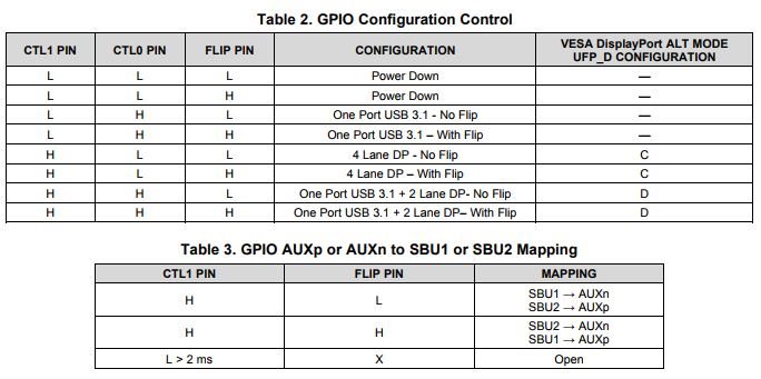

My customer would like to control TUSB564 by TPS65982 GPIO. Which events should be assigned to GPIOs of TPS65982 to control TUSB564 properly?

And My customer would like to know GPIO output logic in the case of UFP_D Assignment E.
But that information doesn't indicated in TPS65982 and TUSB564 datasheet and App note. So please fill the table below.

Hi Onawa-san,
Please refer to the table below:
| USB3 Event | DP Mode Selection Event |
| Assignment A | L | H | |
| Assignment B | H | H | |
| UFP | Assignment C | L | H |
| Assignment D | H | H | |
| Assignment E | L | H |
Some of the pin assignments will have the same GPIO events triggered. The mux will handle these pin assignments in the same manner since either USB3 data or additional DP lanes will be muxed over those channels.
Here is the UFP pin assignment summary from the DP spec:
