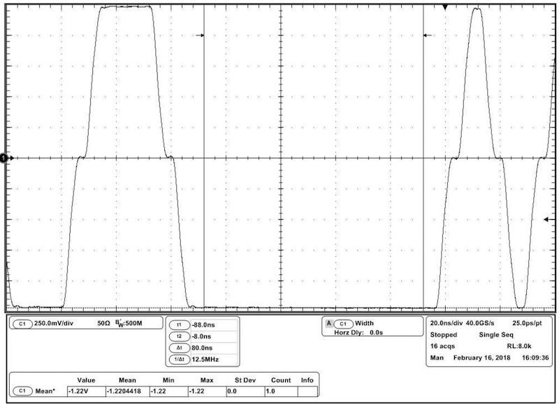

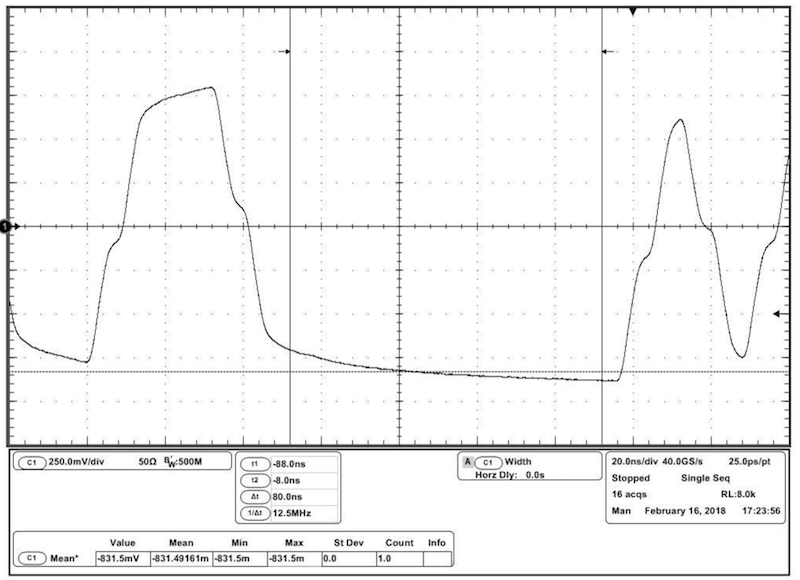

One other initial oddity: a test engineer did some work with a differential probe on the signals.
TDP3500 - Differential probe,
TDSET3 – Ethernet compliance test automation software
Transmit waveform on TX lines looks like this
:While transmit on the RX lines looks like this:
Any ideas for the poor shape? Is the center hitch from reflection? Sorry, I don't know where probe was placed. The first image also looks perhaps like poor length matching?
