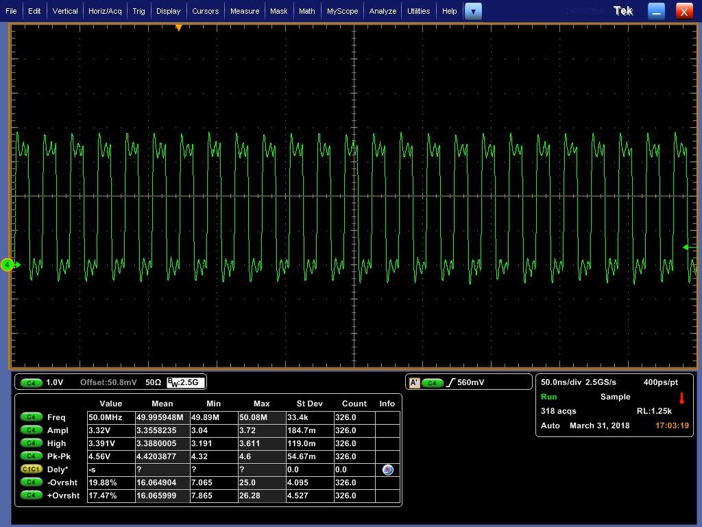

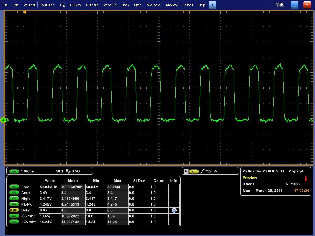

    Interestingly, we are seeing a 50MHz clock from SoC pin! We have isolated communication PCB (where PHY and RJ45 connector are located) & we are able to see the clock in processor board itself. But the problem is, if we disable this pin in software (to use oscillator clock), then PHY address is not getting detected. But if we simply isolate processor clock to PHY (by cutting trace), it works but 20-35% packet loss is there. Please help on this.
    Attached oscilloscope captures of Oscillator clock & Clock from SoC.
    Madhusoodana Bairy
  • Madhusoodana,
    The MAC appears to be (incorrectly) set in Clock-Out mode. Please verify that your Device Tree is setting RMII Clock-In Mode. This can be verified in HW by reading the CTRL_GMII_SEL register (Page 689 of Rev H TRM).
    If this is wrong, I think it likely that your pinmux mode/pad config selections for RMII REF_CLK are also incorrect. Please double-check these.
    Could you please attach (not cut and paste) the DTS file for your board? If you prefer not attach the board DTS please attach the portions related to networking such as the mac node definitions and pin mux definitions. Also please attach patches to any system include dtsi files that have been modified. And finally please attach a patch of any files modified in this directory of the kernel drivers/net/ethernet/ti/
    Schuyler

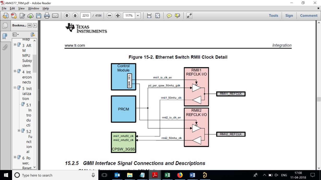

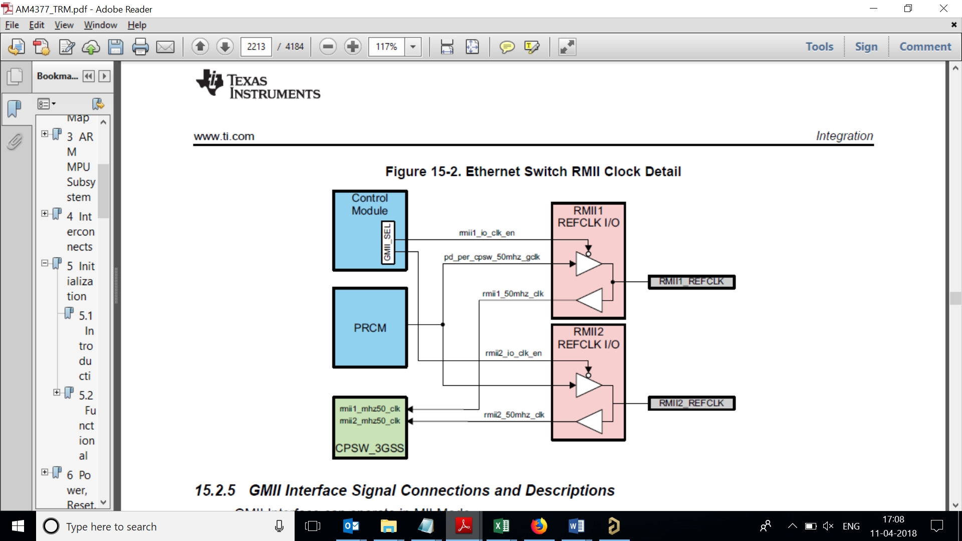

    ing 50MHz clock on RMII_REFCLK even if we have configured it as input! I have attached DTS file. We did not modify anything in the driver.
    Also, can you please suggest what we have to set in the following fields:
    DS0 mode in CTRL_CONF_RMII1_REFCLK Register Field (bits 24-28) (all 0 now)
    CONF_RMII1_REFCLK_RXACTIVE & CONF_RMII1_REFCLK_MMODE bits in CTRL_CONF_RMII1_REFCLK Register (both are 0 now)
    RMII1_IO_CLK_EN in CTRL_GMII_SEL register (0 now)
    Madhusoodana Bairy

    Those interrupts are coming to the processor from PHY. So, processor driver is not sourcing those signals and I think it is only for the status indication purpose when there are any interrupts.
    By the way, we have observed that packet loss got reduced when we change the termination resistors in RMII interface from o ohm to 22 ohm (from 80% to 20%). So any suggestion on this termination resistor or driver impedance in processor ?
    Attached Ethernet Switch RMII Clock block diagram from processor reference manual. As per our understanding, we can use this RMIIx_REFCLK as both input or output. If we are using this as input, then we have to disable
    pd_per_cpsw_50mhz_gclk and use external clock source for the input. If we are using this as output, then we have to enable pd_per_cpsw_50mhz_gclk and we can give this clock to PHY chip as well. Is my understanding correct?

  • Hi Schuyler/DK,
    I found that the issue is with impedance. Looks like the boards are not properly impedance controlled (we got these boards from our customer). However, we are redesigning this for next revision. So, my queries related to termination resistors, reference clock etc are still open.

    As per TRM, RMII Reference clock is input to Processor (ETH1_CLK/ETH2_CLK in schematics). But even though we have configured it as input, we are seeing 50MHz output from this pin. So we have isolated the Oscillator clock and Processor clock currently. Attached PHY side schematics. ETH1_CLK & ETH2_CLK nets in the schematics are the RMII Reference clock inputs to processor's RMII1 & RMII2 modules.
