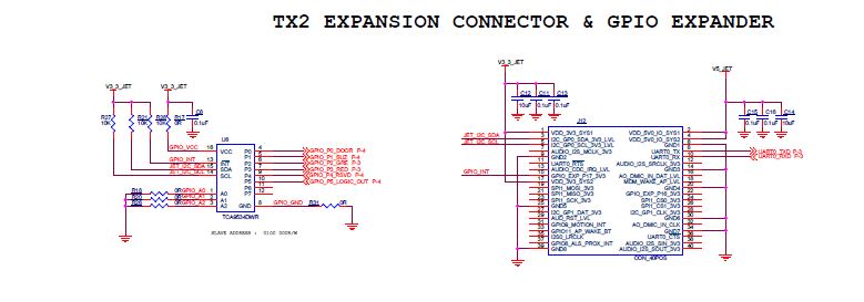

Hello Team,
I am using TCA9534DWR GPIO expander, its voltage rail is 3.3V, and I2C is pull up(3.3v) with 10K resistor. Which is power by using Jetson TX2 developer kit. But after some use its SDA pin shows ground potential and also reduced the impedance b/w VCC and Gnd. The issue was solved when we replaced current chip with new one .What was the reason behind the issue, please support.
