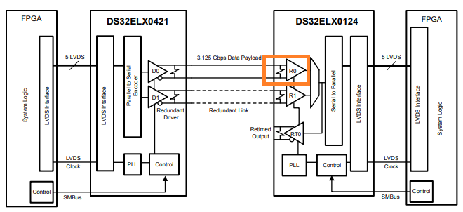

We are developing a DAQ module that will use 32 of these chips to deserialize 32 2.5Gbps data streams. The data signal is from a proprietary sensor that doesn't follow any conventional protocol. We choose this chip because it accepts a DC-coupled signal, and has the ability to disable 8b/10b, DC-balance decoder.

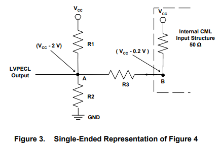

The driver in our system is 3.3V LVPECL, so we need to determine how to couple it to the CML receiver of the DS32EL0124.

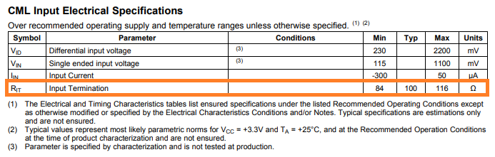

The datasheet only mentions the chip is "self-biased" internally. This is not really enough information to determine how to best couple an LVPECL source to the DS32EL0124. Actually, it's not really enough to determine how to use it with a CML source either. I understand the DS32EL0124 and DS32EL0421 are designed typically to be used together without any external biasing components.
Is there some internal pull-up mechanism? Could you describe the input structure of the CML receiver for this chip?
