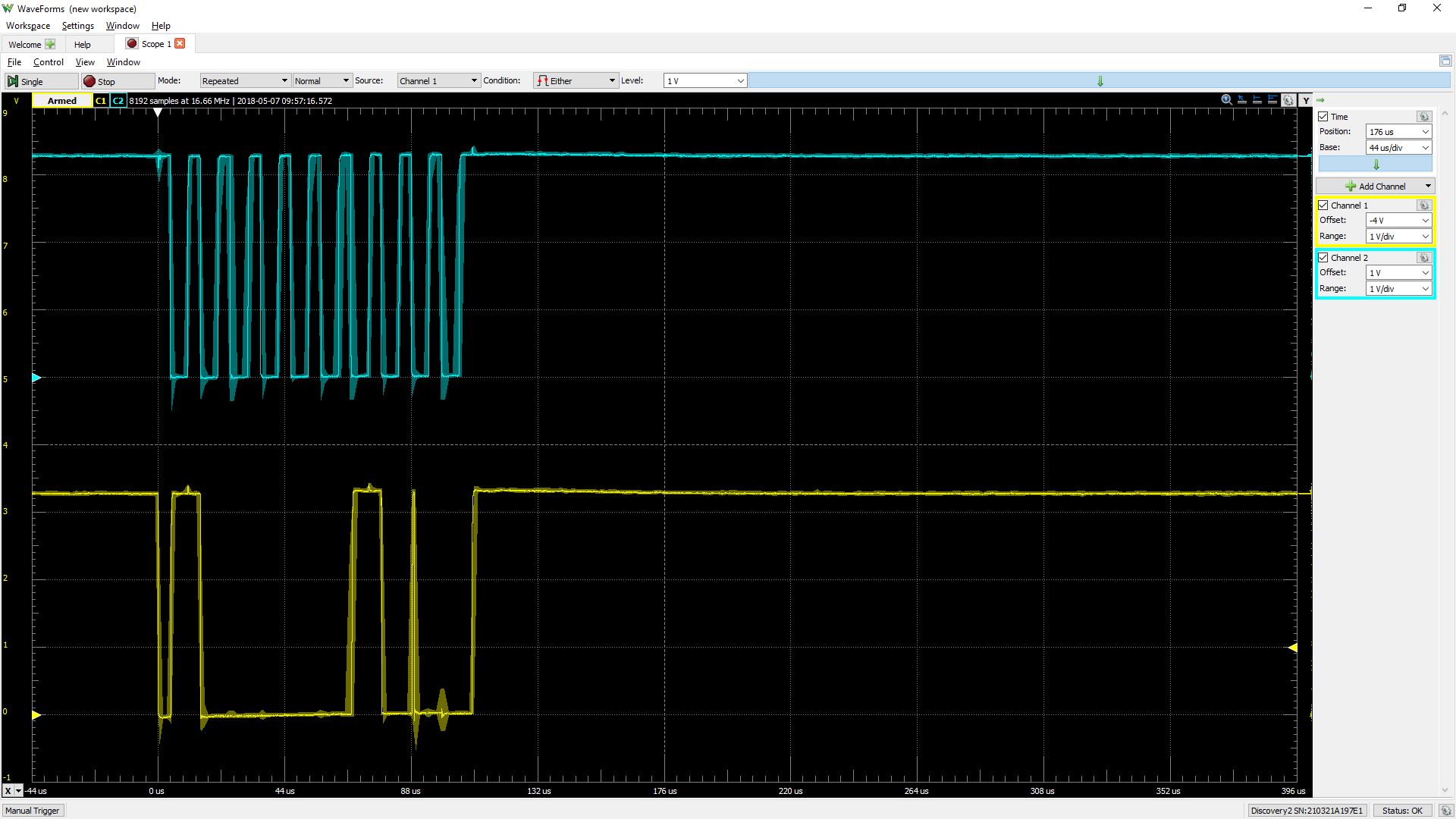

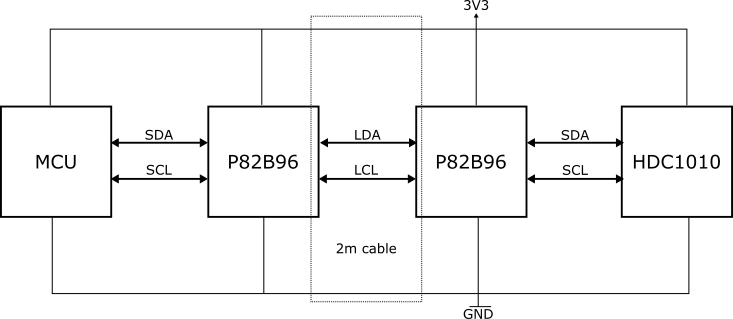

I am working with a system that can be expressed in such block diagram:
My problem is the following: At the start of the program i check each device (7 bit addresses from 1 to 127) for presence (wait for ACK). The HDC1010 connected on the other side of extended network is acknowledging, but then something happens to the bus and the SDA line is not properly pulled up anymore. Its like the net is in some kind of deadlock (0x41 address). I suspect this to be the cause of the P82B96's, as this doesnt happen if I connect HDC1010 directly to the MCU I2C bus. Here are the scope views:
Master side:
Slave side:
The low level "read" by a device is not exactly 0V but around 0.7 V, but thats understandable since I2C buffers are used. The problem is that after the ACK the SDA line should go up, but it doesnt. I am struggling with this for a while now and out of ideas. Also let me say that this problem did not occur from the beggining, but only after couple days and persists now. I checked all pull-up resistors and they are ok. I would really appreciate all help as the case is urgent for me.

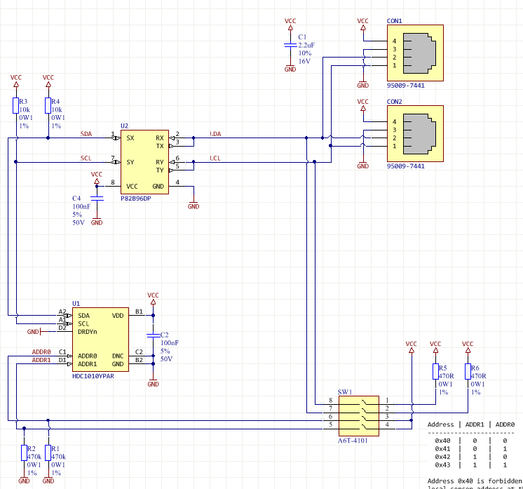

  • Hello Bobby,
    Here are the schematics:
    The HDC1010 end:
    The MCU end:
    I will be able to provide scope views from LDA and LCL at monday, although, from a setup which is still working, as I had to disassemble that one. I hope it will shed some light however, Do you have any insights after seing the schematics? A note from me: The LDA/LCL pull-ups in my config are only connected at one end.
  • Hey Lucasz,
    I don't see anything from the schematic that would point out why this is happening.

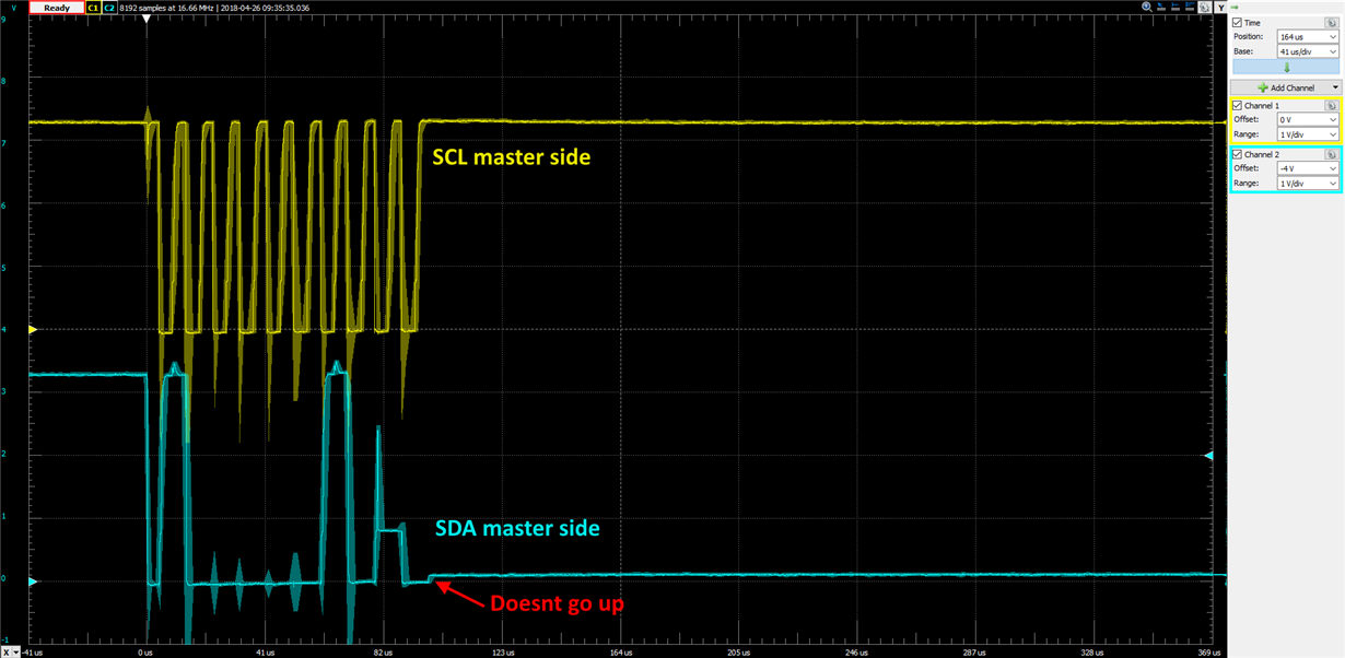

    I looked again at your waveform and what I do see is it doesn't look like the slave (and the P82B96 connected to slave) is the one responsible for the SDA line latching low. The waveform is suggesting the master is the one actually latching low.
    Slave waveform buffers it's output to about 0.7V so that means the L-DA is being driven low (below 0.45%Vcc). Master waveform shows after the ACK it looks like the master is latching the line. If the slave were latching the line then master would see 0.7V on the P82B96 attached to the master. (P82B96 should not be capable of generating a voltage below it's offset at around 700mV because it can only pull low to 700mV).
    My next step here would be to double check code and to remove the P82B96 on the master side and repopulate a new one (maybe our device was damaged and can't receive signals properly). If it works with a new P82B96 then it was our device (damaged?) but if we are still seeing issues I would investigate the code further.
    Edit: you may also want to try testing if you can pass a low to the master side with just the P82B96 device. With the device turned on, pull L-DA low (u can just tie this to GND) and see if SDA is pulled to 700mV.
    Let me know what you find out.
    -Bobby

    That's a tough question as the master is usually the one that is controlled directly. Typically master pulls low on SDA during an ACK, during a start condition, during communication when needing to pass a low, and when initiating a stop condition. None of which seem to be the case here as SCL goes high.
    The waveform does also show something kind of funny.... The master looks like it pulls directly to GND during communication and pulls down to GND again immediately after he receives the ACK (I think he's trying to pull low to initiate a stop condition) but then tries to release but then SDA gets stuck, the signal has a small step to it, like a 100mV offset or something. I'm wondering if there is some leakage current coming from somewhere when this happens......
    Any other devices on the master side other than the MCU and the P82B96?
    Are you able to repeat the issue and then remove the master while the line is still stuck with our device still on? If the bus remains stuck then that will also show our device is malfunctioning and there is another path to GND else where through the device. If the device releases after the master is removed then it will also show the master is responsible for the low.
    -Bobby
  • Hello Bobby, thanks for answer.
    It can be possible though I2C standard is a low is defined as 30% of Vcc or lower which in this case is about 1V which 700mV is below. If there is a line in the code which states if the ACK voltage the master sees is not below say 0.5V then I could see this as a possibility but that just seems like a funny mistake to make.
    Thats not it for sure, I have no control over this in code, as I am using the I2C hardware peripheral of ARM MCU.
    Yes now hen you said it I have noticed it as well. But this wouldnt it indicate that its not the MCU's fault?
    It would be hard for me to remove the master as it is soldered to the PCB with 100 pins. I have however performed such test before posting this: As soon as this occurs, I can no longer use I2C, as SDA is stuck low. So instead after occurance I tried to put the SDA and SCL lines in analog input mode. This way if they were open-drain low for some reason, they would let go and the pull-ups would take the line high. That did not happen however. The only way to "restart" everything, way to make a software reset, and I have to point out that at that point, the power for P82B96 is being cycled, as well as for other external peripherals.
    Does this give you any hints?

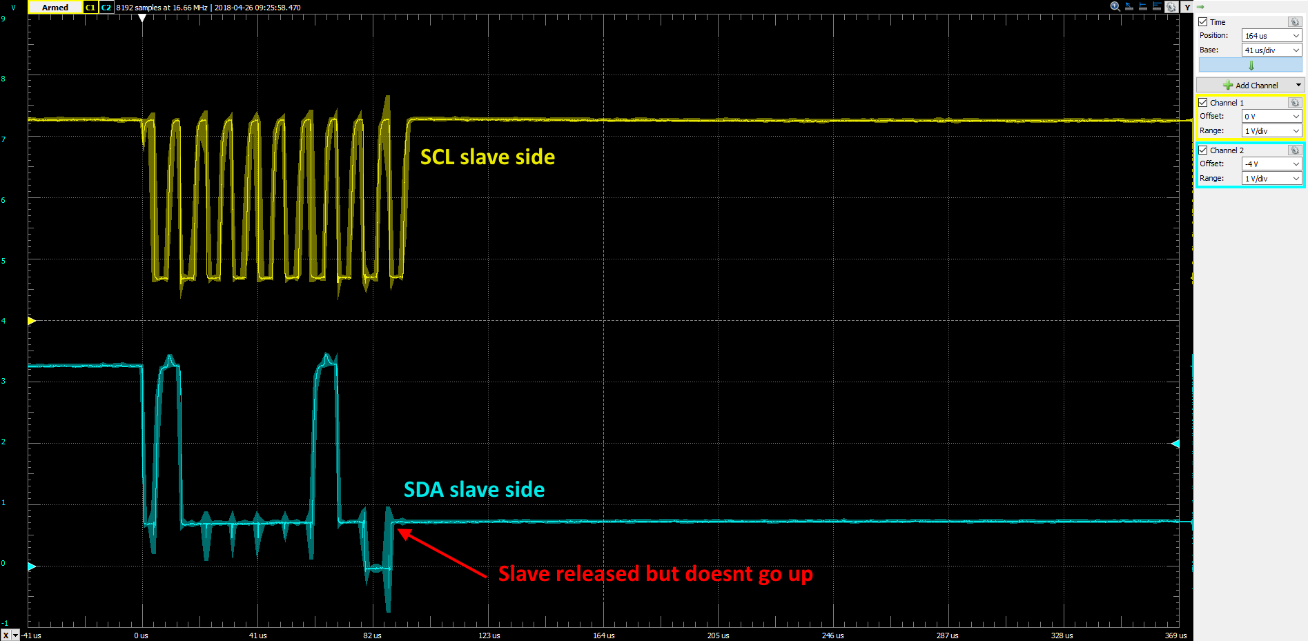

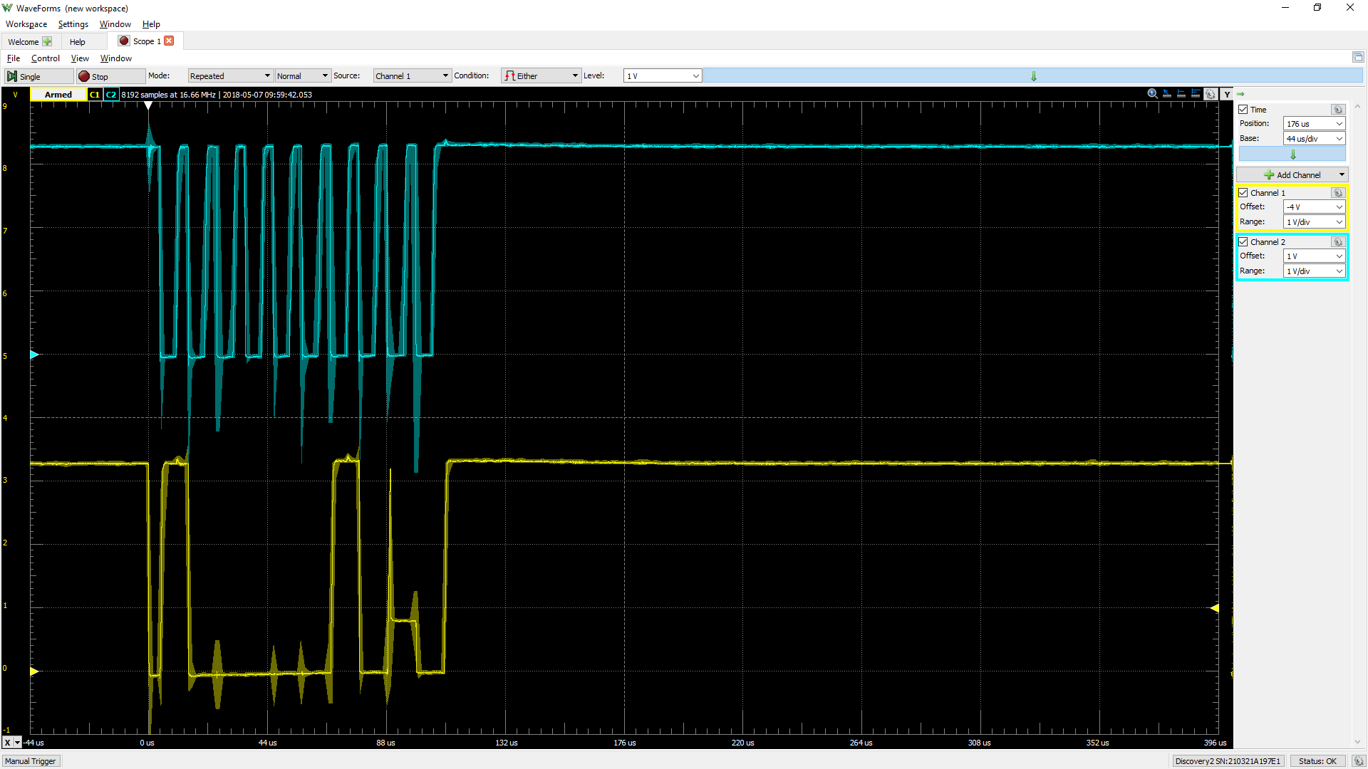

  • Hello Bobby,
    Here I am uploading the waveforms from a working PCB:
    Master side:
    Another run, this time middle side (LDA/LCL):
    And slave side (HDC1010):
    Please let me know either you have any conclusions.

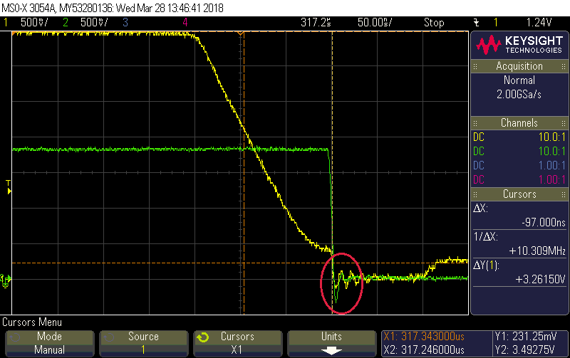

  • Hey Lukasz,
    I don't actually see any issues in the scope shots you've showed me but it may help if we can zoom into one of the transitions from high to low. (resolution of your o-scope could also be a possibility).
    Here is an example of what I am talking about, here the signal when it transitions from high to low causes undershoot. If the undershoot is large enough then the device could be damaged. Sometimes strong pull down FET from a master (like a FPGA) can cause this to happen as well due to the very fast change in current. V(L) = L*di/dt so if there is a large enough inductance (like from a cable) or a fast change in current (like from a strong pull down from an FPGA) then we can see large undershoots.
    -Bobby
