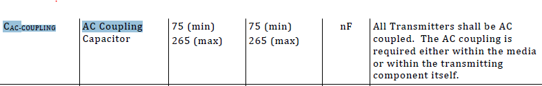

I am designing a system which is composed of a USB 3.0 HUB device (TUSB8041), two on-board USB3.0 devices and two DFP USB3.0 devices, making the USB3 to C conversion using the HD3SS3220 as DFP.
I have a simple question.
There are two HUB ports that are conected to the on-board USB3.0 devices, this connection will need on de USB series 100nF cap in both TX lines, I men on TX HUB side and on TX device side, is this correct?
On the other hand, the two HUB ports are connected to the  HD3SS3220 in order to make the type C conversion, thesee ports are not required of this 100nF caps right?
Also the Host connection of the USB HUB is made via USB type C, so an other  HD3SS3220 will be placed there, again, I think that no 100nF caps are needed. Please Confirm my assumtions are right.
Please find attached the schematic pages of the  HD3SS3220 as DFP configuration, the  HD3SS3220 as UFP (HOST_PAGE) and the TUSB8041 configuration. Can you confirm that the ICs are properly configured?
