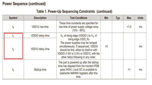

1.What's the meaning of T1 and T2 in  Power sequence~
Is it T1 for VDDIO delay time ,T2 for VDD12 delay time ?

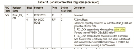

2.How to understand active vedio?If the resolution is wrong, will there be a lock signal?
figure 2

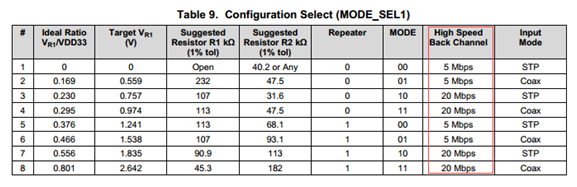

6.Their is High Speed back channel in MODE_SEL1, Does it mean the FPDLINK's transmission rate?

    1. T1 and T2 are the VDD33 to VDDIO and VDD33 to VDD12 ramp delay times. Refer to Fig 15 in the datasheet for the power sequence diagram. A min value of zero means the the supplies may be ramped simultaneously.
    2. RX_LOCK_MODE controls the conditions for RX_LOCK. If this is '1', the lock will be asserted when device is linked to serializer even if active video is not being sent.

    6. No this refers to the backchannel rate. The low speed control channel from the deserializer to the serializer.
