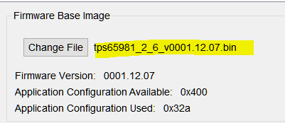

I'm currently making firmware for a product based on the TPS65982.
The product is a SNK only without data.
When running the product through the Ellisys PD 2.0 compliance suite I'm having 5 failures that I'm unable to resolve.
