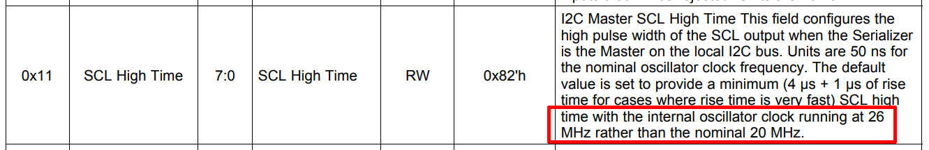

Hi
>with a variance of +/- "20"%.
Datasheet says 26MHz against 20MHz, must it be ±30%?
