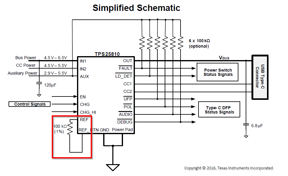

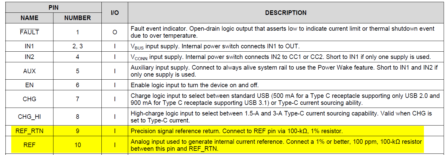

Dear Team:
 Our customer,Wistron,  used TPS25810, but they have HP part number,  and don't know old TPS25810, and new TPS25810 on pin9,10 design.
Could you reply the question?
1.      If 2017 project Type-C DFP controller used 074.25810.0A73, but Pin9 & Pin10 connect with GND independently. The Type-C function can normal working or not?
2.      What’s TPS25810RVCR different for 074.25810.0073 & 074.25810.0A73?
