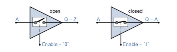

  • Hello Adam,
    A Tri-state Buffer can be thought of as an input controlled switch with an output that can be electronically turned “ON” or “OFF” by means of an external “Control” or “Enable” ( EN ) signal input. This control signal can be either a logic “0” or a logic “1” type signal resulting in the Tri-state Buffer being in one state allowing its output to operate normally producing the required output or in another state were its output is blocked or disconnected, in other words, high impedance.
    So if I added an extra SPI interface connection between my controller and the external flash memory (keeping the SPI connection between TPS65981 and the external memory flash), the extra SPI would be used only to program the blank memory, and it would be kept in three-state mode (high impedance) after that initial programming procedure, letting TPS65981 SPI interface take the control. from that moment on.
    But TPS65981 SPI couldn't interfere during the extra SPI programming phase, that's why I asked about the 3-state feature. If TPS65981 SPI is not 3-state featured, Id have to add a 3-state buffer between TPS65981 SPI and the external flash memory, to isolate them during the first programming phase.
