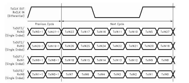

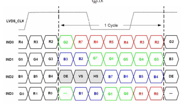

I have a urgent question, need your help to confirm. Customer is doing schematic with DS90C385A and AM570x process. They are using 24bit, pixel per clock.
Now what confused me is that when we suggest customer to do Pin map, we have two different reference from DS90C385A's user guide and Datasheet, need your help confirm which one we should let customer to follow:

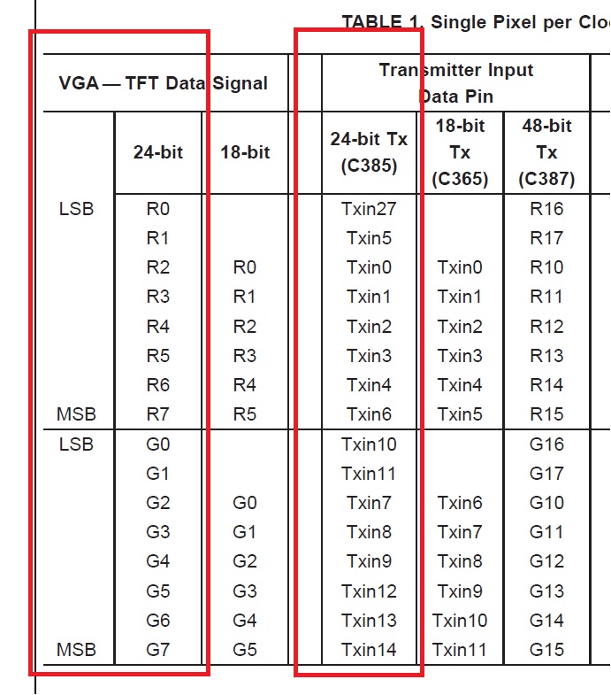

From the User guide:
DS90C38x User guide.pdf
As you can see in the user guide, for 24bit, single pixel clock, the pin map are showed as below:

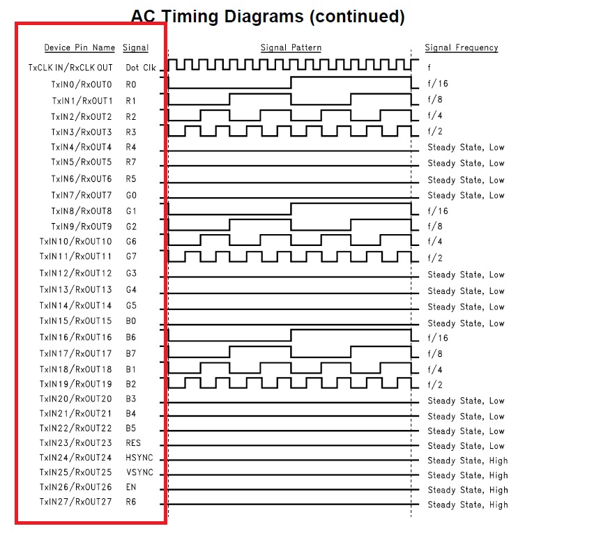

But in our datasheet, the PIn map are showed as below:
So can expert help confirm which one we should let customer to follow? Our AM570x suggest the datasheet version, so how about the User guide's version?
Thanks if you can help quick confirm this, customer is doing schematic now.
