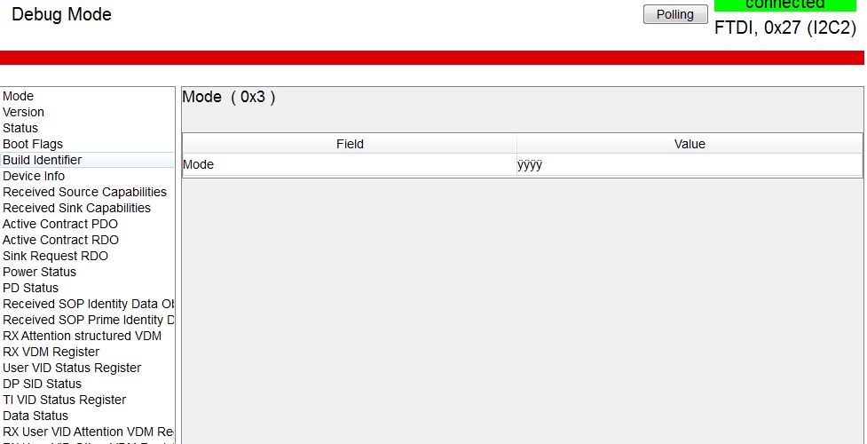

I try to flash the firmware image into the memory chip via SPI. I took the Application customization tool to create my own application firmware. This firmware is running on TPS65981 EVM board but not on my own hardware.
After flashing it seems that every register on the TPS65981 is 0xFF... The Mode register 0x3 is undefined.

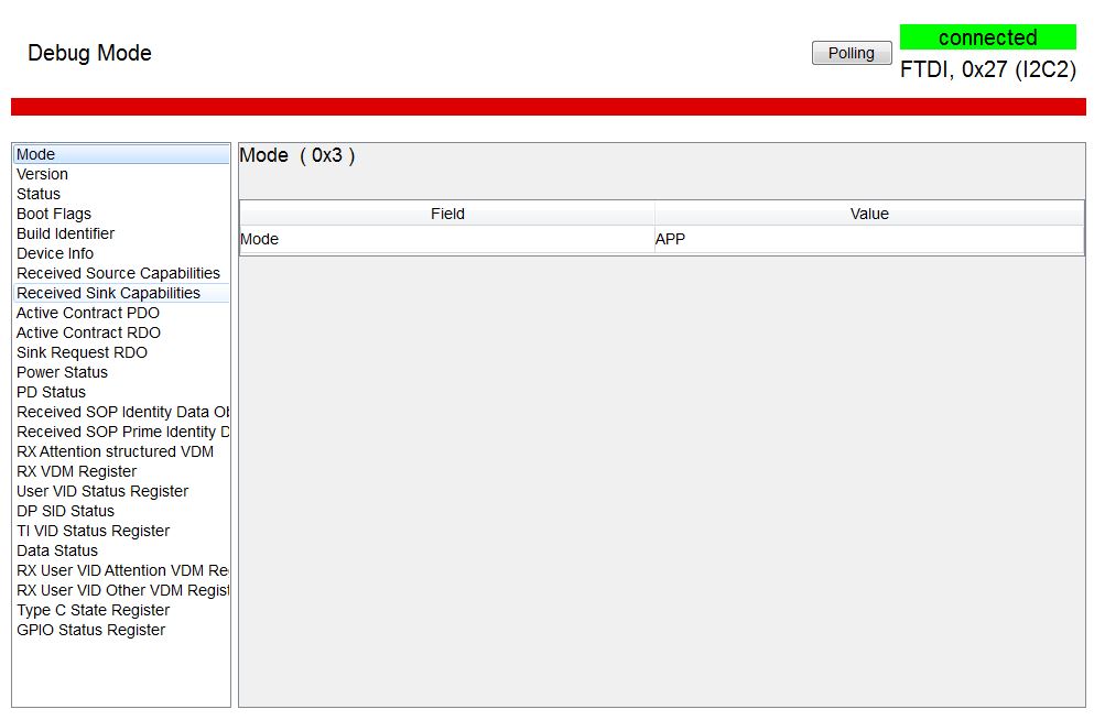

If I flash the recovery file to my hardware it is running --> Mode Register 0x3 is APP.

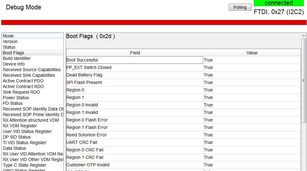

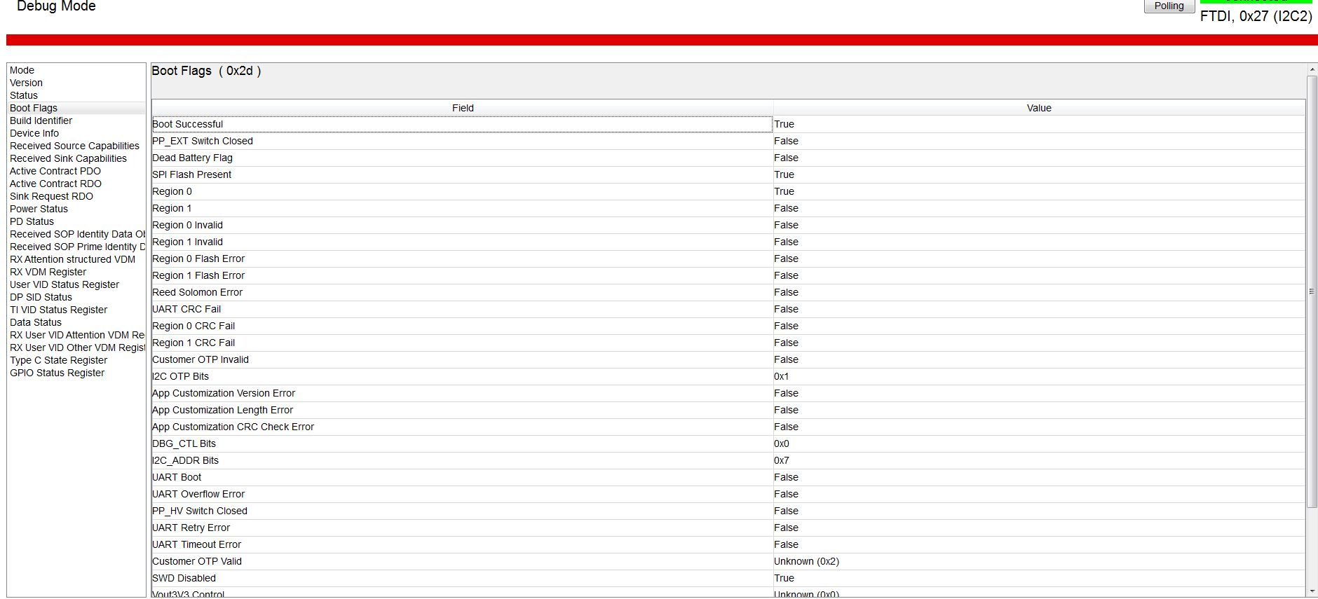

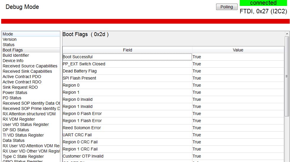

    Thanks for the fast answer. I am not booting from VBUS, just 3v3 input. I also use the latest configuration tool 3.18. Still the same issue, board boots from recovery file on flash. So if I flash own Firmware File every Register seems to be 0xFF.. Here some Register Values of 0x3 and 0x2d:
    Register 0x3 recovery file flashed:
    Register 0x2D recovery flashed:
    Register 0x3 App Firmware (created on TI Application Customization Tool 3.18 and it works on EVM)
    Register 0x2D App Firmware (created on TI Application Customization Tool 3.18 and it works on EVM)

  • Hi Eric,
    thanks fo your reply. I made a few tests with different voltages on Vin. Under normal condtions the Vin Voltage is 3.3 Volts. The device is booting the recovery file on 3.3V but not my own firmware file. If I flash the Device (via SPI) while in recovery application and force a warm reboot command, the device is booting my firmwarefile and everything works as expected.
    My firmware is also working if I regulate the Vin Voltage under 3 Volts instead of 3.3Volts.

  • Hi Robin,
    Is your SPI flash powered from the 3.3V LDO on the TPS65981? From your problem description it sounds like it may not be. I would suggest powering the SPI Flash and SPI pull-ups from the LDO_3V3 pin on the TPS65981. This would ensure the SPI flash is active when the TPS65981 tries to read the config back from it.
