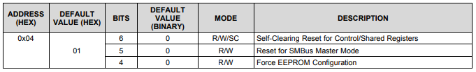

On a design that uses the DS110DF111 that is configured to load from an EEPROM, can we force the devices to re-load from the EEPROM after power-up? Possibly by bringing READ_ENA back to a high state and then bringing it LOW ?  After power on, is there any way to cause a reload of an EEPROM without a power-cycle ?
