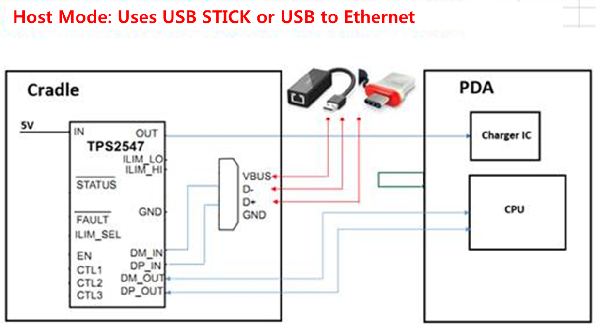

TPS2547 : Cradle application of TPS2547
Part Number: TPS2547
Good morning
thank you for your quick reply.
In addition, we will contact you with the following specifications.
1. Please check if Host Mode Case or Client Mode Case below is supported.
   A. Host Mode Case: PDA connected to Cradle should be operated as Host.
   B. Client Mode Case: PAD connected to Cradle must be operated as Client.
  • I think that your figure is not complete enough to answer your question completely.
    Would it be possible for you to provide a simple figure for each of the modes that shows how the Data and VBUS connections will be utilized. I suspect that an additional power switch and a USB datamux will be required to implement what you intend, but I don't want to assume anything until I understand your system.
