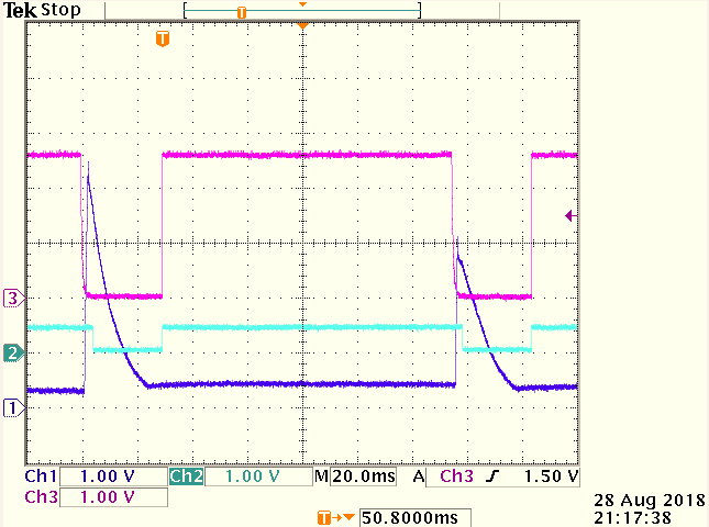

He connects the board with 4-port bus-power USB Hub(BSH4U105C1BK) under default DFP setting of "Application Customization Tool version 4.01", however the behavior is different between "Standard(Recommended)" and "Advanced" as the following.
1)Project -> New Project -> TPS65986 -> Standard (Recommended) -> DFP only
His board couldn't output VBUS(5V) normally. <- abnormal operation

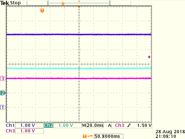

2)Project -> New Project -> TPS65986 -> Advanced -> DFP only
His board could output VBUS(5V) normally. <- normal operation

  • Hi Eric-san,
    I can duplicate the customer issue using TPS65986EVM by connecting USB Hub (BSH4U105C1BK).
    TPS65986EVM couldn't output VBUS(5V) normally. <- abnormal operation
    CH1: VBUS, CH2:CC1, CH3:CC2
    TPS65986EVM could output VBUS(5V) normally. <- normal operation

  • Hi Yaita-san,
    Thank you for the added details. I believe the issue occurs because the standard template sets the Type-C Current advertisement to 0.9A in the System Configuration register (0x28). This setting is hidden in the standard template but can be changed in the advanced template. I would suggest you try changing the Type-C Current setting in the advanced template from 3A to 0.9A to see if you can reproduce the issue using the advanced template.

  • Hi Eric-san,
    I can reproduce the issue to change the Type-C Current setting in the advanced template from 3A to 0.9A.
    Thank you for your support!
    Do you know why VBUS can't output 5V if Type-C Current advertisement is 0.9A?
    Should we consider it as USB Hub(BSH4U105C1BK) rejects the advertisement?
    Yaita
  • Hi Yaita-san,
    Yes, it seems that the USB hub does not function with less than 3A Type-C advertisement.
