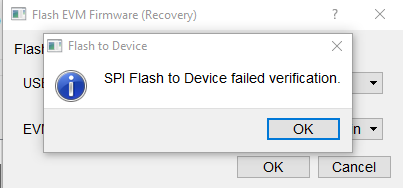

I have bought TPS65981EVM Board. From reference document that I have read, I use "Application Customization Tool" for flash firmware to TPS65981( Flash 1MB). But when flash EVM firmware( and also custom firmare), i face this problem:

Hi Vo Hong,
Do you have the barrel jack connected to the TPS65981EVM when you are flashing your image? Typically if the Flash is failing verification, the SPI Flash chip is not receiving power. I would suggest double checking your connections and checking for power to the Flash.
