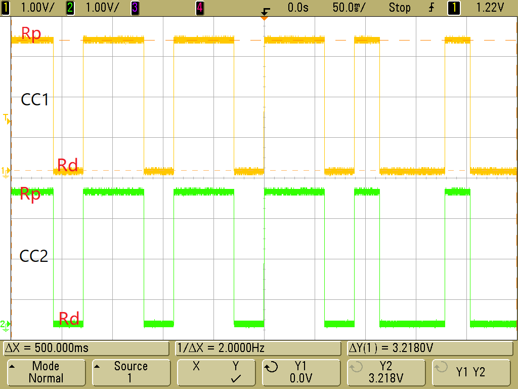

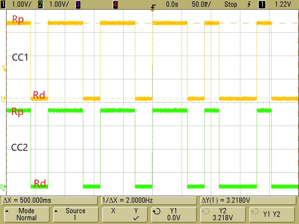

Please let me check about confuse point for TPS65982DA function flow,  procedure steps is below:
I want to know step ④ is correct or not, and the reason of occur step ⑤.
①When Main board(CPU) shift the state to shutdown, it means that PDC (PD controller) will be set to Sink only by EC.
②No device connect with main board's type-c ports.
③Type-C port CC waveform is attached; CH1 is CC1(Yellow) / CH2 is CC2(Green).
④I think that the CC line need fixed to Rd(Low) when set to sink only.
⑤But from waveform this port declare is DRP, not sink only.
Satoshi
  • Hi Satoshi,
    You're correct, the PD controller should only show Rd once configured as PD sink. I think there's some issue with the update from EC.
    Can you share the I2C logs when the EC tries to configure the PD controller as sink?

    Sorry for additional question;
    For example, above board with TPS65982D named "Board-1", another board with TPS65982 named "Board-2".
    I find both(Board-1 and Board-2) CC same output toggle(Rp/Rd) when set in Sink only.
    If connect Board-1 and Board-2 to one Dual role type-c device(with AC adapter) and has probability power role recognize fail.
    Question; Is there any other different factor between Board-1 and Board-2 PDC which leading this issue happened?
