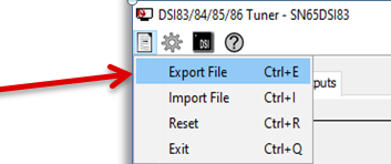

  • Hi yaqiang,
    No I mean the .dsi file from the DSI-Tuner configuration. You export it after filling out the parameters. For example:
    I.K.
  • HI I.K:
    Sorry, my mistake.
    Attach again.
    yaqiang15inch.zip
