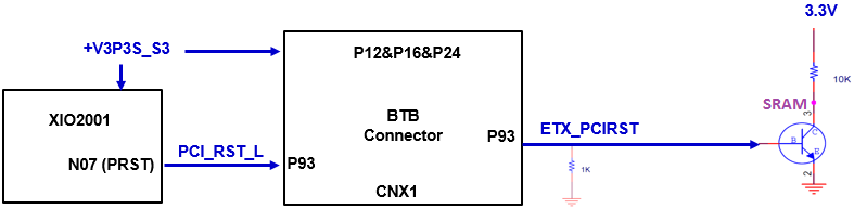

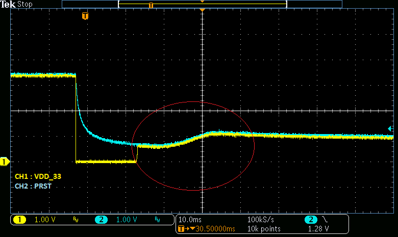

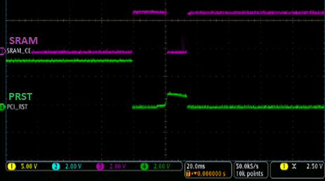

We use XIO2001 and find PRST have a glitch when system power off.
The waveform is as below.

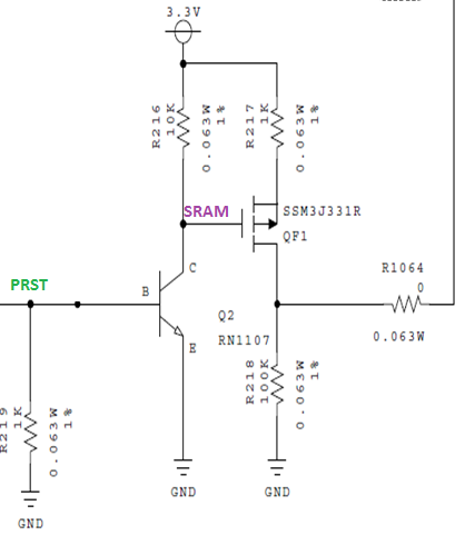

Our end customer use PRST directly connect to BJT and only have a pull low 1k resistor from XIO2001 PRST output.
Now this glitch will occur BJT false action.
Could you help check the PRST glitch is the same problem as attached mail.
Have any idea to eliminate PRST glitch.
