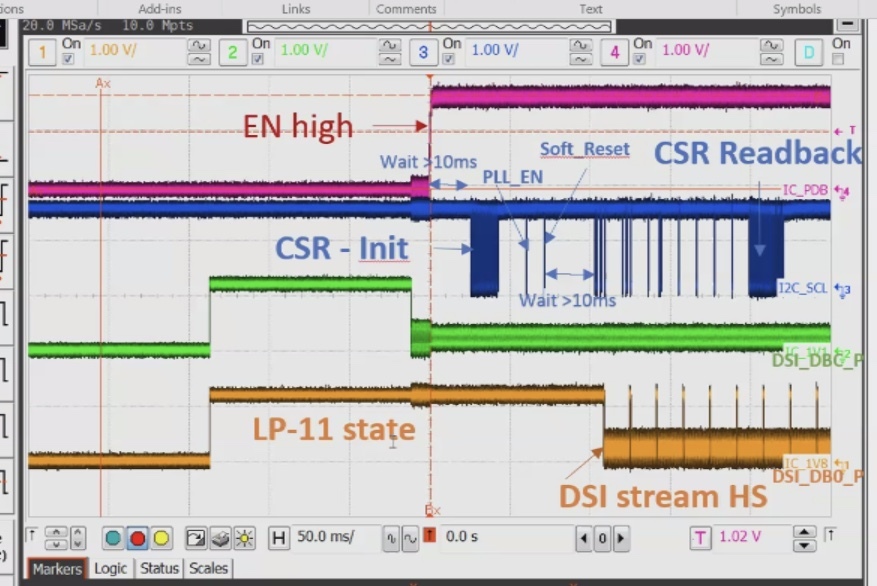

SN65DSI85: Horizontal and vertical sync error on Sn65DSI85
Part Number: SN65DSI85
  My self Varun,We are using MIPI-LVDS converter, We are able to get RGB strips when test pattern is enabled in DSI tuner tool, but eventually we are not seeing any image without test pattern for this SN65DSI85 bridge. Clock we are getting almost 52MHz at output, and pulse also were generated from RXIN0- RXIN0+ till RXIN3- RXIN3+ . Can can one help out solving issue?
