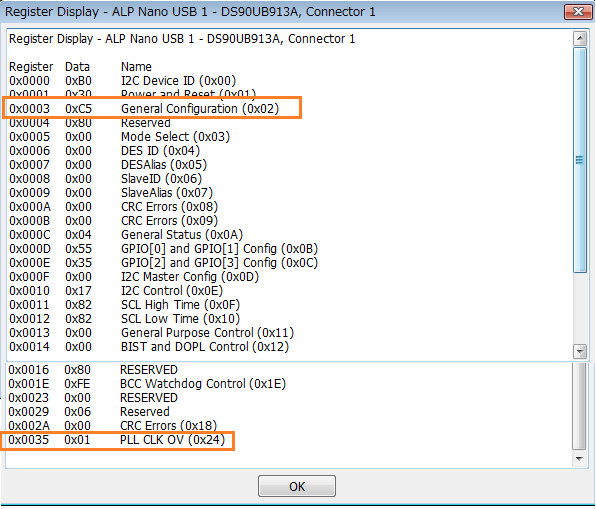

    Would you be able to provide a register dump for your device so that I can compare the register settings?
    Jonny
  • Hi Jonny-san,
    >I also ran tests with just the 913, and in both cases, the FPD Link III output was synchronized with both external PCLK and internal oscillator.
    Did you refer you could synchronize FPD Link III output with external PCLK using 913 EVM only from start to end? (not using 914 EVM)
    It is strange because there is difference between your result and us.
    I put register dump as the following. (using 913 EVM only: FPD Link III output isn't synchronized with external PCLK)
    I put additional information (Note 1 to 3) for your reference.

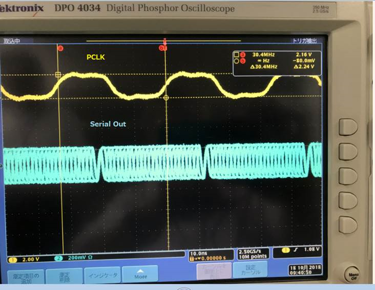

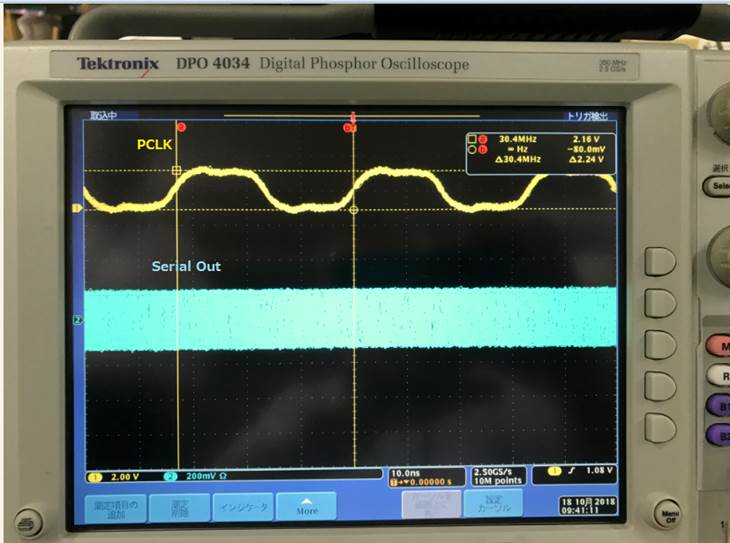

    Note 1) External PCLK & Serial Out of DS90UB913A EVM without connecting DS90UB914A EVM from start (power-up) to end
    Note 2) External PCLK & Serial Out of DS90UB913A EVM after connecting DS90UB914A EVM
    Note 3) EVM Jumper/Switch settings
    Yaita
  • Yaita-san,
    Yes, I was able to achieve a synchronized output with the PCLK for the DS90UB913A-Q1, even when not connected to a 914 beforehand. I looked at your register dump and it is comparable to the register dump I extracted when I observed the synchronized output.

    Please let me confirm about "synchronized" meaning.
    We saw the following waveform to judge if serial data outputs based on external PCLK or internal oscillator.
    Note 1) External PCLK & Serial Out of DS90UB913A EVM without connecting DS90UB914A EVM from start (power-up) to end <- PCLK and Serial data are not synchronized
    Note 2) External PCLK & Serial Out of DS90UB913A EVM after connecting DS90UB914A EVM <- PCLK and Serial data are synchronized
    Could you check your waveform in this point?
    Yaita
