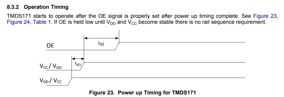

I have an another question about Power on Sequence.
At Fig 23, it is shown the power up sequence.

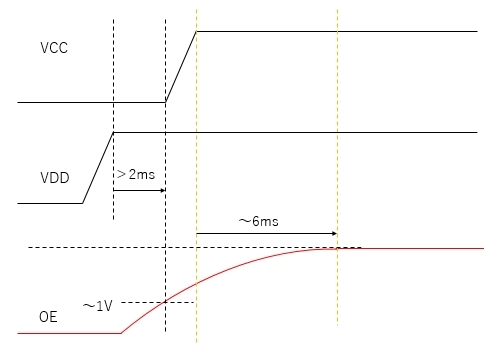

On the other hand, at the customer's board,OE pin voltage is start up to very slowly. (Please see the following waveform.)
Is this acceptable for as the correct power up sequence?
At the customer's board , this device may be into Standbymode when the power up is as above. (The TMDS signal is not output.)
What the register we should confirm whether this device is in standbymode or not?
We are considering why the TMDS output is not output when the power up sequence is as above.

    The TMDS171 supports several methods of power management. It can enter power down mode using three methods; (1) HPD is low; (2) Writing an 1 to register 09h[3]; or (3) de-asserting OE.
    Have you checked HPD and see if it is high or low?
    If you shorted the OE ramp time, do you then have the video output?
    David
      Yes. The voltage of this pin(#33: HPD_SNK) is 3.3V at abnormal operation such as above. And #4 pin(HPD_SRC) voltage is 3.3V as well.
       They will check.
    On the other hand,the some of register value was different at normal operation and abnormal operation.
    OK: 1Ah=46
    1Bh=08
    1Eh=08
    NG; 1Ah=46
    1Bh=0A
    1Eh=0A
    And this phenomenon is appeared 1 sample of 3 samples.(means 1 board of 3 boards)

    0x1Bh and 0x1Eh are BERT error counter, are they sending the data while the OE is still ramping up?

    It is maybe "Yes".
    They are using a cable such as include data line and power line. So that , the voltage and the signal is provided immediately when the cable is plugged in to the board.
    Is this kind of usage not acceptable for this device?
    Or is there any concerns?
    Koji Hamamoto
  • Koji-san
    If the source is sending the data while OE is still ramping up, this can be an issue since TMDS171 is still in power down mode. So they need to make sure TMDS171 is in normal mode before doing the link training.
