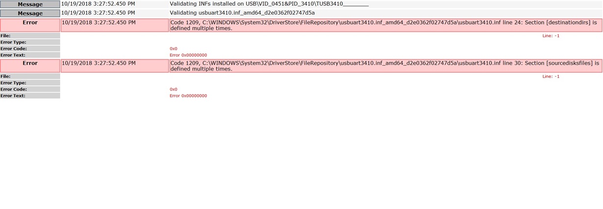

Hi Nicholaus, thank you for responding. I have been going through some Microsoft tutorials regarding driver signing for windows 10. However, they seem to be general and some of the steps appear to be missing. I have also try calling them but their customer service (Microsoft) keeping sending me to different departments and so I am in a circle. I tried following the Microsoft tutorial of creating the ".hlkx" file that needs to be submitted and the test are failing on the modified driver (INF file modified only) provided by Brian. I have attached the screenshot where 47/50 test failed. Any help would be much appreciated. I was thinking since TI went through the process thereby having more experience and knowledge.

Hi Nicholaus, I installed the original driver signed for Windows 10 and tried the HLK test on it. I tried the "DF- InfVerif INF Verification" but it failed. Please see error below. I am also getting error in the modified TI installer as well. Maybe I am not testing it correctly. Do you know the process to get driver signed? Thanks in advance.
