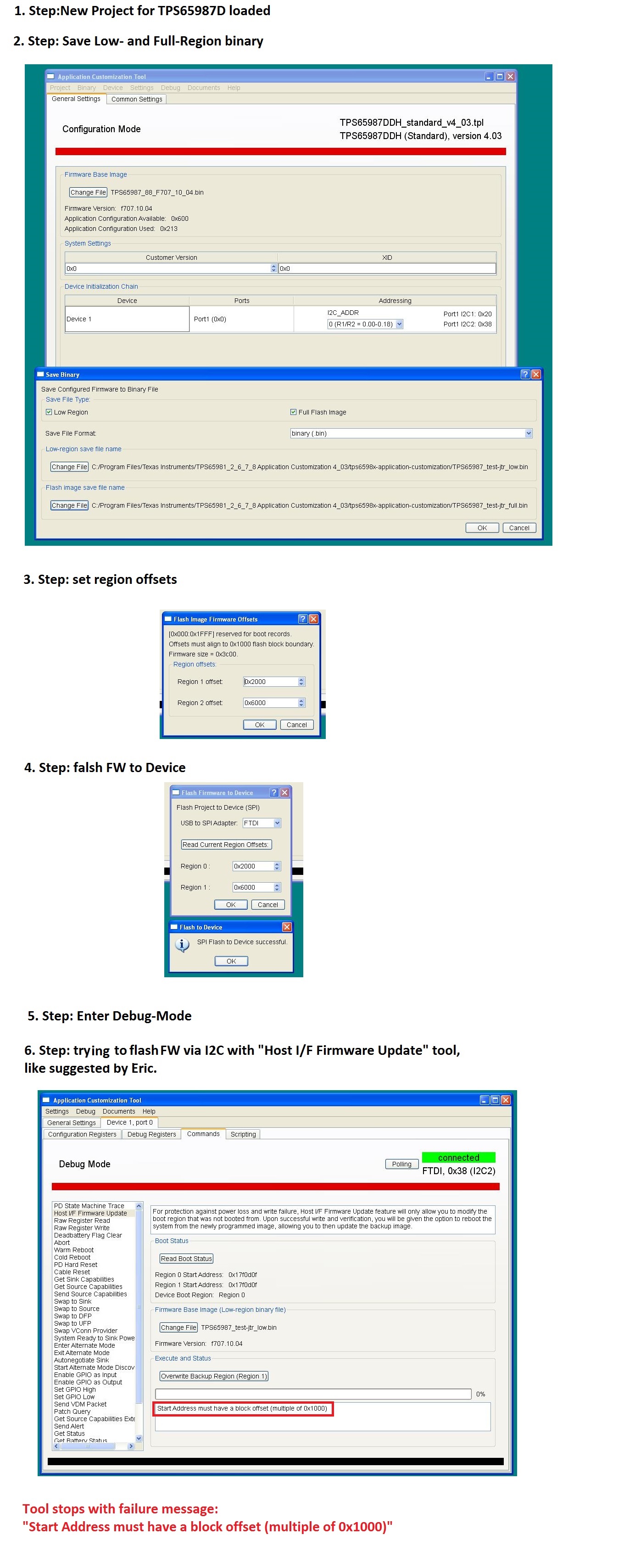

Hi Eric
we are still trying to program the TPS65987D over I2C but do get errors with 4.03. Please find the picture below and let me know if you have any ideas:
