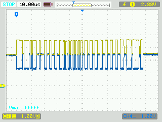

I’m setting up two TCAN4550 modules to send messages back and forth but I’m having a problem with the Transmit operation.  I'm trying to send a Standard ID CAN message with 32bytes of data.  I was expecting to see a single transmission with a length of ~290us but what I’m seeing is a repeated 67us length transmission.  This transmission gets repeated every 91.6us.  I've attached a Word document that shows my setup along with some oscilloscope captures that show the transmissions.

  • Hi Eric,
    1.) I setup my code where it would transmit 3 times then Cancel the transmission Request. I then added a ~1 second delay before looping back around to transmit 3 more times. After each attempt, I read the Error Counter register and saved it off to a variable. I set a breakpoint just before the 1 second delay.
    The TEC variable in the Error Counter was set to 0x80 and never incremented. The REC remained at 0x00.
    2.) The data being transmitted sort of looks like the data I was expecting. I maybe off or have my Endianness wrong but what I was programming was
    Header #1: 0x0014 0000 (@0x8100)
    Header #2: 0x0185 0000
    Payload: 0xCCCCAAAA, 0xCCCCAAAA, 0xCCCCAAAA -->
    What I captured on the scope was: (Reading the graph from left to right)
    1st Byte: 0x04
    2nd : 0x28
    3rd : 0x5A
    4th : 0xAA
    5th : 0xAA
    6th : 0xCC
    7th : 0xCC
    (It looks like a total of ~ 75 bits are being transmitted before the sequence starts over)
    3.) The 2nd device that's pictured (Green Board) uses exactly the same setup as the TCAN-EVAL Board but the transmitter is not enabled. It simply stays in Normal Mode and does nothing.
    Let me know if you need my register settings.
    Joe

  • Joe,
    Thank you for this, it helps tremendously. One thing that confused me is you have two messages going to register 1058, which is an interrupt mapping configuration register. Is this intentional?
    It looks as though one byte of your intended data payload is getting through and then the message abruptly stops. Then the controller continuously tries to re-transmit until it sends the message correctly, which never happens in your case.
    The TEC variable being set to 0x80 means that that bit field was 1000 0000, which would indicate the Error Counter is at 128, and this was set only after 3 transmits? When the event counter >127, the device goes into error-passive mode. But if it's not incrementing after that and the transmission repeat is still happening, then that doesn't explain the issue.
    Can you probe RXD and GPO2 while the transmission repeats are happening? And have you ever let them go to see how long before the controller stops?

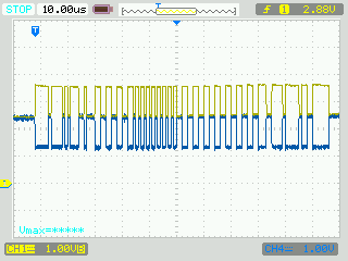

    [JEC] It looks like 6 bytes of data are being sent. And yes, this message is continuously being transmitted. The message appears to be:
    0x04   0x28   0x5A   0xAA   0xAC  0xCC   0xCA   0xA7

    I changed up the message and can see that some of the data is being transmitted from the buffer. The Headers don’t seem to match.
    [JEC] I reran the TEC increment test.  This time, I powered the TCANEVAL module down completely which forced the Error Count Register to 0.  If I monitor the TEC variable directly after a power cycle, I can see this it does increment from 0 up to 128 in steps. Once it reaches 128, it stops incrementing.  Periodically I can see the CEL variable in the Error Counter Register toggle between 0 and 1.   What's odd, RESETs the chip just before initialization.  I was expecting the Error Count Register to return to zero after the RESET but it remains at 128.  The only way I have been able to get the Error Counter back to zero is through a power cycle.
    I have attached a document that contains some scope screen shots.  The interesting thing that I found was the very first few transmissions look different from the other transmissions.  The length of these first transmissions is not correct but it is different.  I also made some comments in the attachment about GPO2 and GPIO1.
     4810.Scope Screen shots.pdf
    Let me know if you need anything else.
    JC
  • Joe,
    Thanks for the clarification on the writes, and I guess it's good that there are no errors being detected.
    In the first scope shot, the end of the frame looks like it has 6 dominant bits, followed by 11 recessive, which is the active error flag (6 dominant bits for the active error, 8 error delimiter bits, and 3 interframe spacing bits). In the second screenshot, there are ~24 recessive bits which resembles a passive error flag, but there 7 recessive bits too many; there should only be 17, 6 recessive for the passive error, 8 error delimiter bits, 3 interframe spacing.
    Can you turn off the DAR bit in register '1018? It is bit [6]. What might be happening is that since your other device is transmitting nothing, the device that's continuously resetting is getting no acknowledgement so it sees that as a transmission failure, but logs no error for it. Disabling the DAR bit (writing bit[6] of register 'h1018 to 1) should stop your device from continuously transmitting the same message over and over.
    Let me know if this changes anything. And thank you very much for your patience while we try to figure this out.

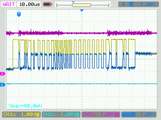

  • Hi Eric,
    I updated the code with the request you made.  See below.
    //-- Put the Chip into Normal Mode
    CAN_Write(dwCommPort,&TCAN4550_W_CCCR_NORMALMODE[0]);      // 0x1018
                                                               // Control Register
                                                               // Clear the CCE and INT bits
                 ORIGINAL CODE                   UPDATED CODE
         TCAN4550_W_CCCR_NORMALMODE[] =       TCAN4550_W_CCCR_NORMALMODE[] =
              0x61101801,                         0x61101801,
              0x00000100,                         0x00008140,
    CAN_Write(dwCommPort,&TCAN4550_W_NORMAL[0]);             // 0x0800
                                                             // Mode of Operation - Normal
                        TCAN4550_W_NORMAL[] =
                          0x61080001,
                         0x084404A2,
    With the DAR bit set, my test only transmits a single message.
    I set my scope up for "Single Shot" Mode so this is the very first transmission right after the chip is initialized.  The transmission looks like the screen shot I took before.  If I keep repeating the transmission, all messages look like the scope shot below.
    Joe

    I made some code updates so the Bit timing I'm using is now set to 1Mbps.  I double checked the code on my prototype board and made sure the device at the end of the CAN Network was in Normal Mode but remains Idle.
    As I was running this test, I noticed that the Transmission data changes.  It appears that the TX data change is linked to the Error Count.  When Reading the Protocol Status Register, I noticed that the information being passed in this register also changes based on the transmission.
    The first few transmissions look like:
    During transmissions that look like the picture above, the Protocol Status Register reports:
    BEFORE TX:    0x0000070F
    DIRECTLY AFTER THE WRITE TO THE TXBAR REGISTER:  0x0000071F
    AFTER THE TX: 0x0000070B
    After ~10 transmissions, the TX Data changes to:
    BEFORE TX:    0x0000076F
    DIRECTLY AFTER THE WRITE TO THE TXBAR REGISTER:  0x0000077F
    AFTER THE TX: 0x0000076B

  • Joe,
    The difference in the two frames is due to the active error message sent at the end of the frame vs. the passive error frame sent after ~10 transmissions. This is due to that TEC value we looked at earlier, prior to reaching 128, the device will output 6 consecutive dominant bits followed by 11 recessive bits to signify an error-active state of the device. Once the TEC gets to 128, the device goes into error-passive and starts transmitting 6 consecutive recessive bits followed by 11 more recessive bits as the error flag, and this is the passive error. The source of this error isn't obvious though, especially since the LEC bits told us nothing.
