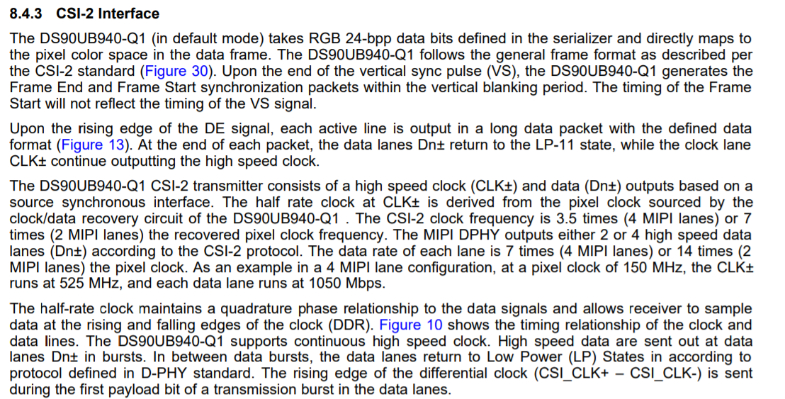

in DS90UB940 manual I found the following:
8.4.4 Input Display Timing
The DS90UB940-Q1 has built−in support to detect the incoming video format extracted from the FPD-Link III
datastream(s) and automatically generate CSI-2 output timing parameters accordingly. The input video format
detection is derived from progressive display resolutions based on the CEA−861D specification. The video data
rate and frame rate is determined by measuring internal VS and DE signals.
I am wondering if I can get video data and frame rate somewhere in the registers.
