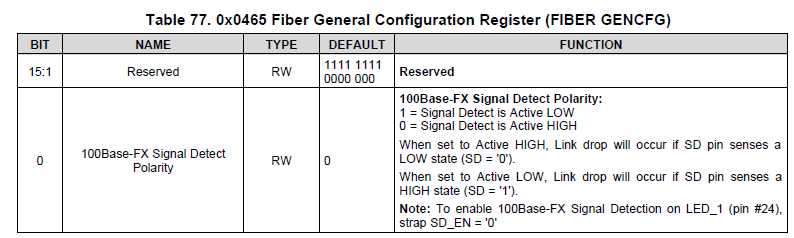

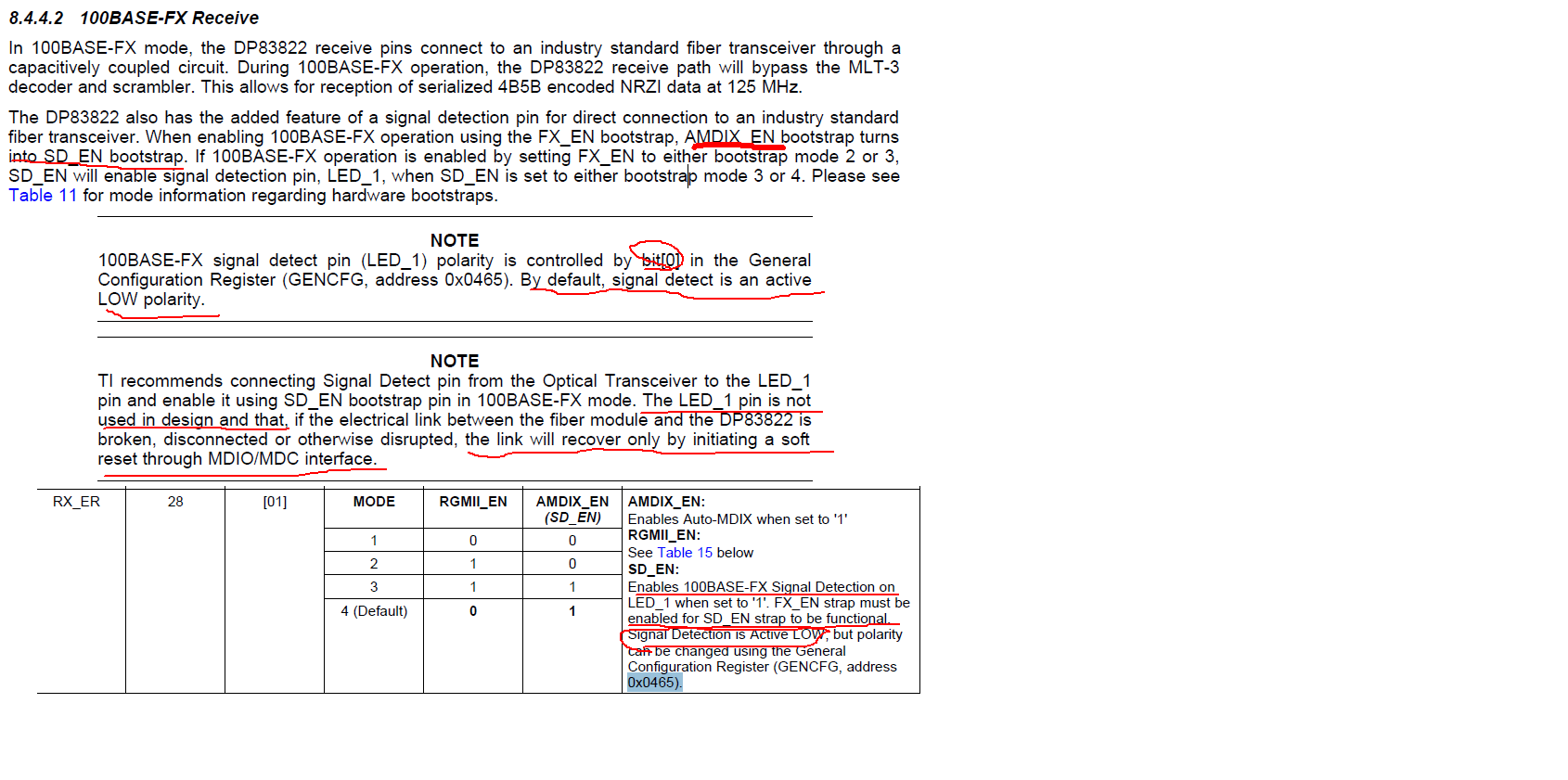

We are using DP83822IF in our design, it is working in RMII mode , I still confused about the signal detection polarity, because I set RX_ER bootstrap in mode 1, the following datasheet says signal detection is active low.
but we have read register 0x0465, the value is 0xff00 , that is to say, signal detection polarity is active high , we haven't configure the register in our code, why the value of signal detection polarity is not the default active low, is the bootstrap setting matching the value of register 0x0465.
another question i want to ask ,can I disconnect SD pin between DP83822 and SFP in our design ?, can you send me some reference design of DP83822 working in 100M-FX mode, thanks
