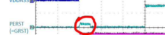

  • Hi Malik,
    I'm sorry for the delay.
    I have some updates.
    1. I got signal waveform from my customer. Please take a look at attached file.
    XIO3130 PWR_CLK_I2C_signal.pdf
    2. GRST is pulled-up to 3.3V externally.
    3. GRST and PERST of XIO3130 are connected to same reset signal.
       This reset signal is also used for resetting other CPU.
    4. I2C SCL and SDA are pulled-up to 3.3V via 4.7kohm resistor.
    There was no power supply rise waveform of power-on sequence,
    so that I'm requesting again.
    best regards,
    g.f.
  • Hi Malik,
    I received power-supply rise waveform of power-on sequence from my customer.
    Please take a look at the attached file.
    And I want to know that asserting/de-asserting GRST and PERST in same time
    are allowed or not for this device XIO3130.
    best regards,
    g.f.
    XIO3130_Waveform(Power-up Sequence).pdf
  • g.f.,
    It seems there is a small glitch in the PERST/GRST signal. Could the PERST/GRST be controlled externally such that this glitch is not present to see if the problem persists? The high voltage of this glitch appears to be higher than the specified low voltage for PERST/GRST. This may cause the part start the internal state machine before REFCLK is registered as valid.
    Also it is valid for PERST and GRST to be tied together.

  • Hi Malik,
    I had a reply from my customer.
    They told me that reducing this glitch is unpossible.
    Because after powering on the board, it takes a few msec to setup the PIC microcontroller
    and then the RESET will be asserted for specified time.
    The level of glitch in PERST/GRST signal is 0.4V and
    this is under the range of XIO3130 specification.
    From datasheet, VIL of input pin is 0.3*VDD33 = 0.99V.
    And here are new information from the customer:
    this issue occurs not only just after power-on, but also it occurs when
    starting up from manual RESET. In such case, there no glitch in PERST/GRST.
    Are there anything else to check?
    best regards,
    g.f.
