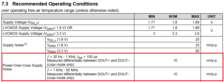

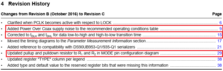

Would you please help me to clarify the point below with regards to the datasheet update (Rev. B to C)?
<Q1>:
With regards to the recently added specification “Power-Over-Coax Supply Noise”, if the board cannot meet this, what kind of issue can be expected on DS90UB913A-Q1 and its link?

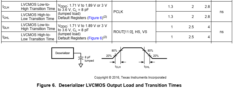

<Q2>:
It seems that no “tDLH” and “tDHL” notation in the Figure 6.
Are same 20-80 conditions applied for “tDLH” and “tDHL” as well?
<Q3>:
This should be typo…”Deserializer” is the valid name.
