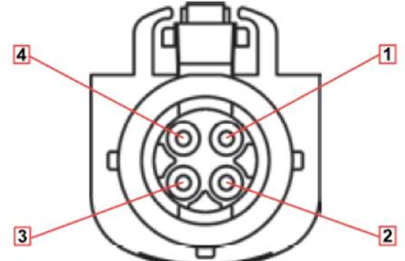

As we know, there are some verified design of Power over Coaxial, but we want to transmit two high speed diff signals through one connector, so we select a STP connector as below.
This connector has four pins, but we need two pairs of high speed diff signals and two power line.

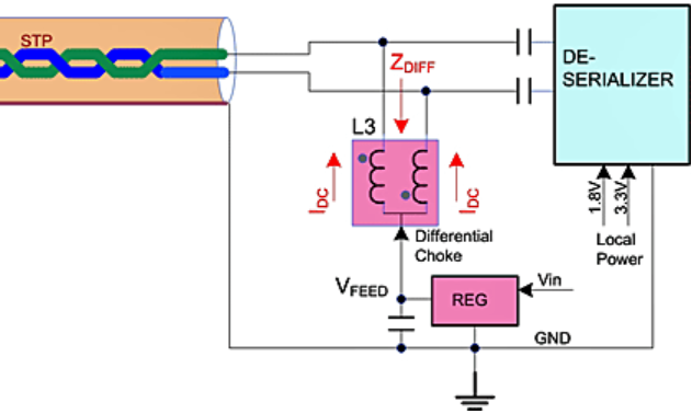

And TI engineer give the below article, it describes the details of Power over FPD-Link concept. Link as below.
https://www.eetimes.com/document.asp?doc_id=1279219

We use two pins (for example pin 2/4) of STP connector as one diff signal, , simultaneously as the power line. And the other pins 1/3 as another diff signal and reference ground.
In the our design diagram, the power source is from the 954 board, and 953 board sink power.
So, the connector pins 1/3 and 2/4 on the two pcb boards all need some filter parts to split the high speed signals and the DC powers.
Now, we need confirm if this design is feasible and then we should confirm all these filter part’s parameters, such as ferrite bead and inductors.

    yes, TI has some study on PoC with coax cable and STP/STQ cable. For your questions, please refer to Power over Coax deep analysis on some key design point as PoC for either coax or STP/STQ has similar design guideline, some points:
    1. PoC network should protect the high speed link SI performance and tolerate the PoC noise -- AC feature
    2. PoC network can support the power consumption required in the end-equipment -- DC feature (inductor, FB, cable should support the maximum
    unfortunately TI have no Power over STP/STQ test data support your request. but you can refer to above two points to design your reliable system.
