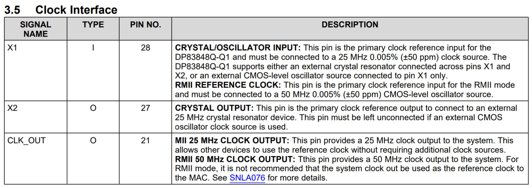

Hi Team,
RMII is used in DP83848Q, is there any way to disable CLK_OUT? Thanks!
Best Regards!
Hao
