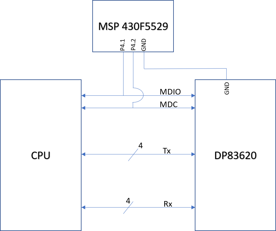

  • This block diagram is representing the way I am connecting the MSP LP with the DP83620.
    Please note that this is just for the MSP LP connection verification, in actual design there are more signals between CPU and DP83620 PHY.
  • You shall isolate both MDC and MDIO from CPU while using MSP430 LP. Otherwise two source are driving the same bus
