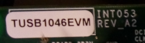

I'm trying to access the TPS65982 on our TUSB1046EVM evaluation board trough I2C with a Totalphase aardvark which connects to J8.
The TPS65981_2_6_7_8 Application Customization 4_03 tool works correct with aardvark SPI, hence the "Device->Re-Flash EVM Firmware (Recovery)" works fine.
Only when trying to access connect I2C Port 1 (I2C_SDA1/I2C_SCL1) or I2C Port 2 (I2C_SDA2/ I2C_SCL2) no response, tried the "SWEEP I2C address range for response" option without any luck.
