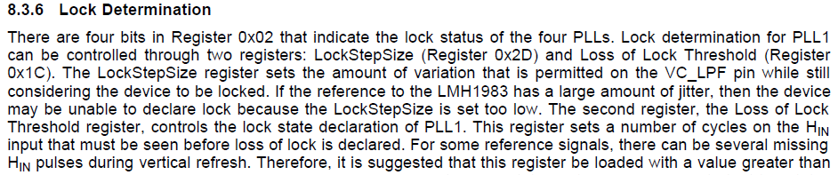

On datasheet page16, section 8.3.6:
...LockStepSize (Register 0x2D) and Loss of Lock Threshold (Register
0x1C). The LockStepSize register sets the amount of variation that is permitted on the VC_LPF pin while still
considering the device to be locked....
       Qestion1: Could you elaborate Threshold of actual number of plus count at VC_LPF pin outputted pulse detect to?
The second register, the Loss of Lock Threshold register, controls the lock state declaration of PLL1. This register sets a number of cycles on the HIN input that must be seen before loss of lock is declared. For some reference signals, there can be several missing HIN pulses during vertical refresh. Therefore, it is suggested that this register be loaded with a value greater than six (Loss of Lock Threshold > 6).

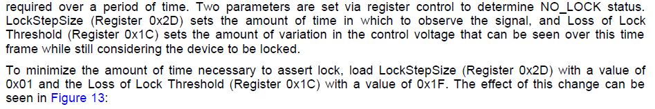

In your previous e2e reply:
What the datasheet is explaining is that to make the LOCK determination time the fastest, you load LOCK STEP_SIZE with a 1 (minimum amount of time to look at pulses) and LOCK_THRESHOLD with a 31 which is a large number, indicating that even if there is significant activity, the device should declare LOCK.
        Question 3: Are those statement saying same behavior?  Following your e2e description, our understanding is that the value of "Loss of Lock Threshold" is time domain window of pulse count measurement at the VC_LPF pin. Unit of time window is Hsync periods. Is that correct? Then what is the relation between the statement of "Sets the number of Hsync periods to wait before setting loss of lock." on the datasheet?
It seems value of "Loss of Lock Threshold" is just Waiting time to set Loss of Lock register after detected certain number of plus at VC_LPF pin. There looks no function of plus measurement "time window". Would you please summarize those three descriptions and re-describe "Loss of Lock Threshold" function in simple words?

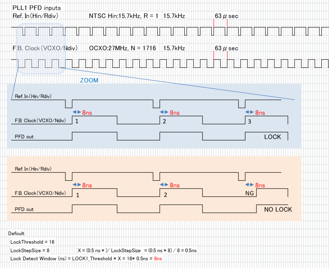

    For the PLL1 lock detector, LOCK1_Threshold is the primary control (lock window size) while LockStepSize is more like a secondary control (window step size).  Here are more details:
    The PLL1 lock detector compares the two PLL1 PFD inputs, PLL Ref clock edge (Hin / R_div) and PLL Feedback clock edge (VCXOin / N_div).  If 3 consecutive edges are within the lock detection window, it declares PLL1 is locked.  If 3 consecutive edges are outside the lock detection window, it declares PLL1 is unlocked.
    The Lock Detect Window sets the allowable clock phase difference between PLL1 PFD inputs.
    • Lock Detect Window (ns) = LOCK1_Threshold * X
      • Default Lock Window = 8 ns because LOCK1_Threshold = 16d and X = 0.5 ns (since LockStepSize = 8).
    • LOCK1_Threshold register (range: 0 to 31d, 32 steps, X ns/step) sets the lock detect window.
    • LockStepSize register (range: 0 to 15d) adjusts the ns/step size (X).
      • X = (0.5 ns * 8) / LockStepSize
      • When LockStepSize = 8 (default), then X = 0.5 ns/step (nominal).
    Examples:
    • For Fast lock detector assert time (= relaxed frequency accuracy = Largest window size), set LOCK1_Threshold = Max (31d) , LockStepSize = Min (0).
    • For Slow lock detector assert time (= strict frequency accuracy = Smallest window size), set LOCK1_Threshold = Min (0), LockStepSize = Max (15d).

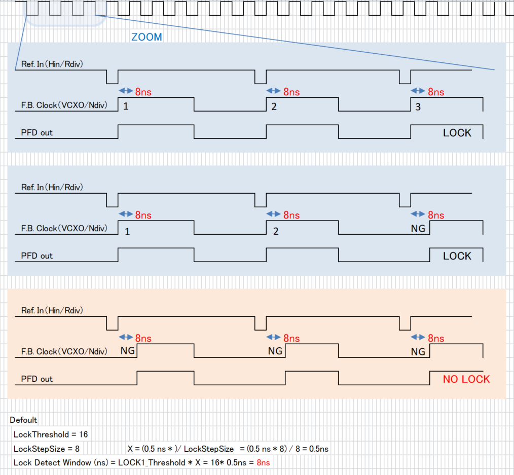

    We made some timing chart as attached in NTSC format.
    There is our understanding of LOCK detection of 3 consecutive edges at PFD output. Could you verify this pattern?
    Mochizuki
  • Mochizuki-san,
    One correction: FB Clock needs to be outside the lock detect window (e.g. 8 ns) for 3 consecutive cycles before the NO LOCK status is asserted.
    Alan
  • Hello Alan-san,
    We appreciate your prompt comment.
    Then how is below drawing?
    Mochizuki
  • It looks good!
    Alan
